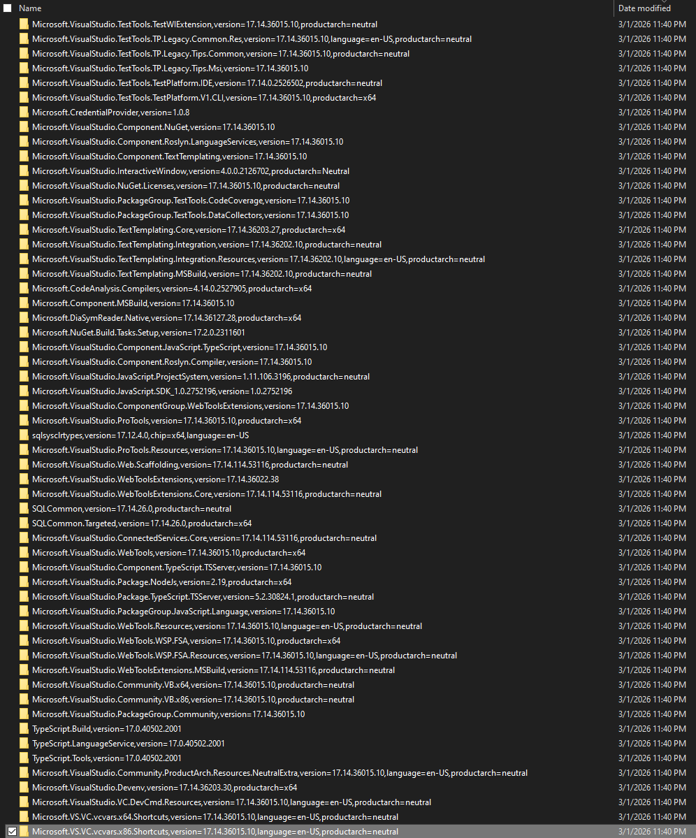

I... I can't reproduce the crashes anymore.
I haven't upgraded my intel graphics drivers. I haven't updated Davinci resolve studio. I haven't installed any windows updates other than antivirus updates...
I have exactly one suspect, and one suspect alone. Visual Studio.
I tested and confirmed several times when I last posted on the 1st that the crashes were still occurring.
The only major change that I would have made to my testing environment is updating visual studio.
About 23 hours after that post, I launched VS and updated several components related to visual studio 2022.
I rarely use visual studio, so many of the components were likely old. The last time I updated anything was 6/12/2025 MMDDYYYY.
Launching the visual studio installer, selecting modify, it shows that I only have the workload `Desktop Development with C++` selected. See attachments.
I just don't understand... It worked fine on the older driver... How could this have fixed anything...
I'll update in the morning. It's late. I feel like I'm going completely mad.
Sorry if this is a wild goose chase. PLEASE let me know what information I can get for you.
For now, give me a few days to poke around and see if I can get it to crash again... If I can't, It may be related to the above. Maybe I'm just extremely lucky right now, and tomorrow morning we'll be back to the same old familiar BSOD...
