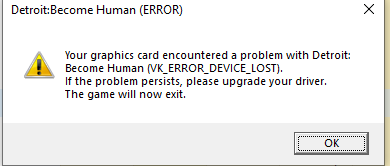

好,当我玩《底特律变人》时,游戏开始前会出现一条消息(第一张图片),现在,当我尝试开始第11章“从死里复活”时,我的游戏立即崩溃(无论你图形设置如何)。请帮帮我。

I have already updated my Intel® Arc™ graphics driver to a newer version than 31.0.101.4824 (currently using version 32.0.101.8136). After trying the previously steps I mentioned before, the game no longer crashes during Chapter 11, “Back from the Dead.” However, later in the game, it still occasionally shows the following error message before crashing:
Detroit: Become Human (ERROR)
Your graphics card encountered a problem with Detroit: Become Human (VK_ERROR_DEVICE_LOST).
If the problem persists, please upgrade your driver.
The game will now exit.
Please let me know if there are any additional steps I can try, or if there’s a recommended driver version that is more stable for this game.

As per the link that I provided:
This message can be ignored since it is hard-coded on the game itself.
The game should run fine with Intel graphics drivers 31.0.101.4824 or newer.
Let me check, aside from the message, are you having other issues? If you click "OK", can you play the game normally?

After clicking "OK", I can continue playing the game normally for a while. However, later in the game, it still occasionally shows the following error message before crashing:
So while the game runs after confirming “OK,” it eventually crashes again with the same error and crash.
