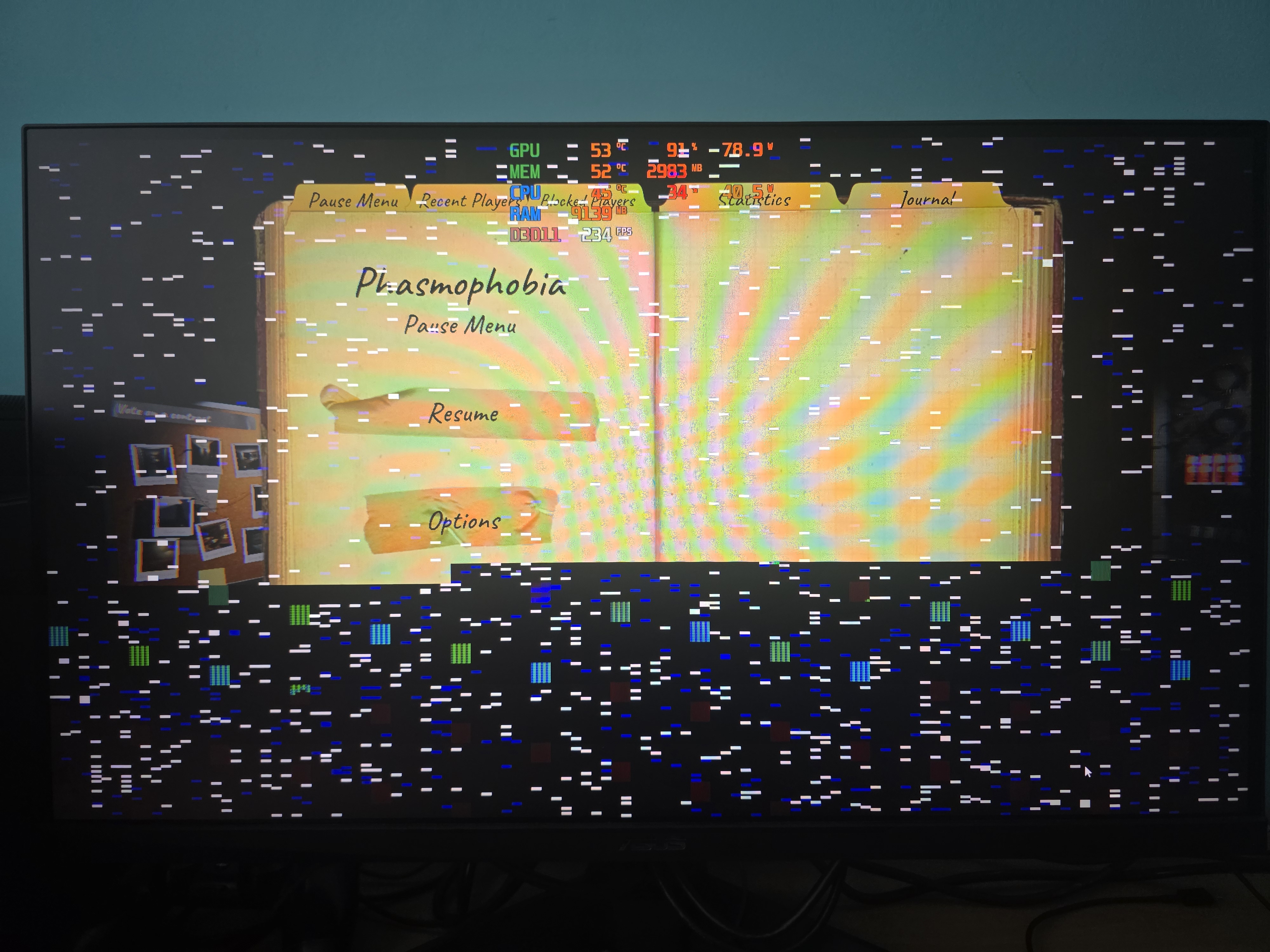

Visual corruption/artifacts when playing games on intel Arc B580
GAOQSX78
143 Views
GPU: Intel Arc B580 12GB
Driver version: 32.0.101.8509
CPU: Intel Core i5-10400F
Motherboard: ASRock Z590 Pro4
OS: Windows 11 Pro
Resizable BAR is disabled (Will enable in the future)
Games concerned: Phasmophobia (version:Last update Dec16,2025) and HellDivers 2 (version : 01.006.003 [17692] (prod_slim)-Last update Feb10,2026) have only noticed it in these 2 games.
Issue Phasmophobia: Visual corruption and artifacts appear on screen when changing video settings in Phasmophobia. The entire screen fills with random colored pixels. The only fix I found is to restart the game.
Issue HellDivers 2: Visual corruption and artifacts appear on screen but the situation is more complicated. There is not always a chance that it appears but when it appears I have found multiple areas it could appear in .
  1. When starting the game there is a chance that it appears and the only way I have found that fixes it sometimes is to restart the pc but it doesn't always work
  2. When screen sharing on discord it appears and to get rid of it you need to stop the screen sharing
  3. When ever anything related to windows appears over the game, for exemple ,when I turn up the volume sometimes the game artifacts but the little widget that shows the volume is fine or when I press the windows key on the keyboard and the windows start menu . The only way I have found to fix it is to close the windows start menu or wait that the volume pop-up disapears .
THE VISUAL CORRUPTION DOESN'T ALWAYS APPEAR IN HELLDIVERS 2

To everyone reading this the issue has been resolved by enabling Resizable BAR
