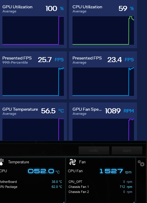

I went from getting an average of 80-110fps on high graphics in games like pubg, once human, dayz, and hell let loose, to not being able to surpass 40fps, (average around 30) on the lowest settings. This was immediately after i finished the latest update of .8531. The only game that performs unaffected is battlefield 6, which I surprisingly get 80-90fps avg on high graphic settings like i normally do. Temps run fine, cpu utilization seems normal, but gpu is always at 100%, where it usually floats around 99%
Specs: Arc b580, Ryzen 5600x, 1440p 200hz monitor, 32gb ram.
I switched to ethernet, hoping it was my internet, but no change.
I don't know if its the gpu update, or something else. Note that I experienced the same issue with the windows January KB5074109 update. it made games unplayable due to low fps, and i had to roll back to the previous update. that fixed it entirely until this gpu update. Windows is still at its previous version, so i dont think that would be the issue.

updated reply since intel cant add an edit feature:
i have rolled back my gpu to 8509. updated my bios on b5550m-a ac, did a repair on my current version of windows (24h2 nov 2025),
updated my chipset, and even clocked my ram to 2900 (max 3200).
Still no fix!

Hello SeamusD,
- Please tell me how you updated the driver.
- For me to review the hardware and the driver installed, please help generate the SSU logs of your system. Kindly refer to the link below for the steps:
