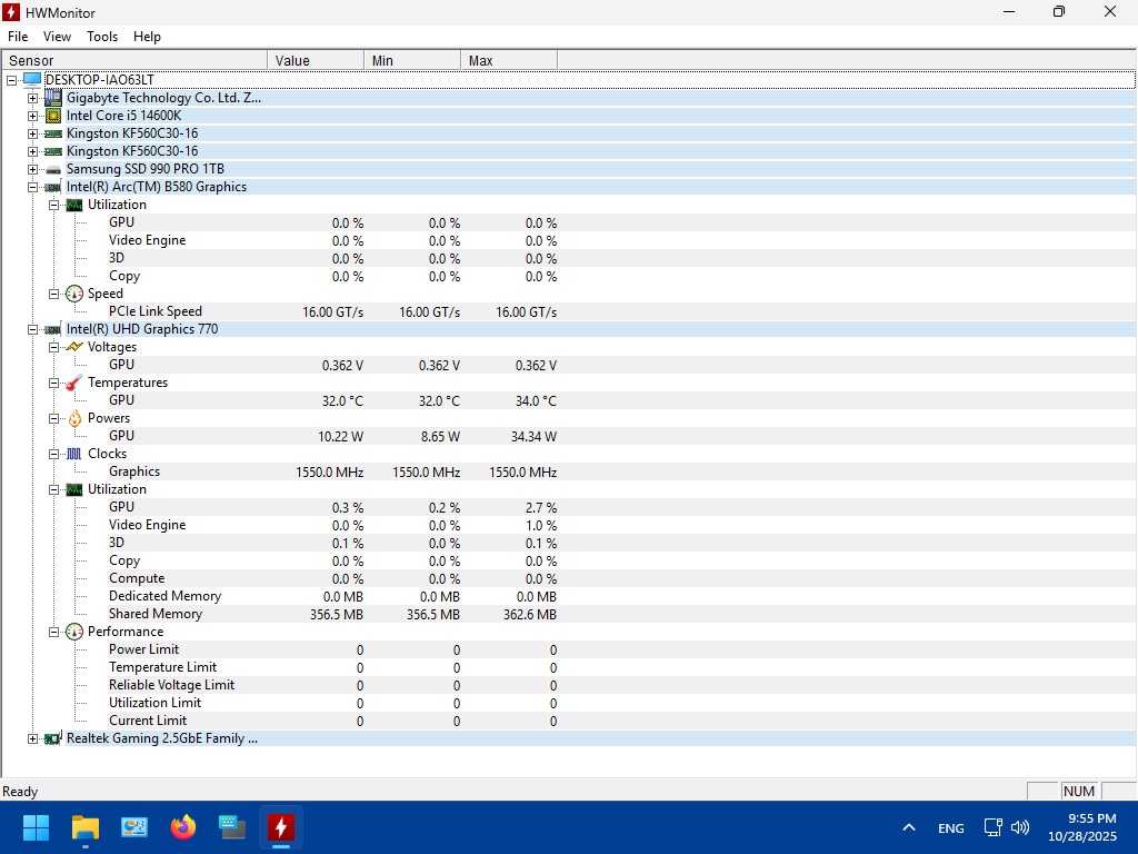

i just build a system and after a month installed a intel ARC B580 in the beginning after the installation everything was good and successful and for certainty of successful installation i checked in the Task manager and the Graphic Card was recognized and i had not any chance to test it in a game or any program because of a notification about new bios update and after the updating everything was broken and the Graphic Card is in Recovery Mode , i tried every solution but it is still in Recovery Mode and i know it is a little issue but i can't find it . i tried to New Windows installation - New driver installation (new or older one-Manual installation of driver or with DSA - all possible Bios versions ) - but did't work , so i need help to resolve this issue .
For better understanding i attached a SSU Report.

• i did't reset the BIOS after the update but one time i did it too to make sure everything is set to default .
• the Resizable BAR is always enable .
• in Device Manager appears without any error ( Device Status : This device is working properly ) so it recognized correctly the only thing is in Display Adapters -> Recovery Mode .
• there is not a another PCIe slot for Graphic to testing it .
• The clearing of CMOS is done .
• Always using Display Driver Uninstaller (DDU) in Safe Mode befor reinstalling the latest version from the Intel website .
• i should add that when i change the BIOS configuration to :
initial Display Output=PCIe 1 slot Internal=Disabled
or
initial Display Output=PCIe 1 slot Internal=Auto
i get a message in Intel Graphic Command Center = Your Current system configuration is not supported by intel Graphic Software (attach 5) .

I downloaded the last version of DDU via the link above and try it again to remove and install the last version of the driver , i understood that when i,m in safe mode there is no Recovery Mode but when i booting into the normal startup ( No Safe Mode ) the Recovery Mode showing up .
Attachment available for better understanding.

1 . the issue is definitely related to the BIOS update, as the problem only appeared after the update was applied .
2 . It is installed in PCIe slot 1 ( PCIEX16 ).
3 . Unfortunately, I don’t have access to another GPU or PC to test .
4 . I made some further research too and discovered that the firmware of the card might have been damaged due to interaction with the newer BIOS and the firmware may have become confused while trying to adapt to the new version of BIOS update, eventually leading to a failure to function properly. It seems that the issue can only be resolved with a firmware update .
However, I haven’t yet found an option to update the firmware and there is no option in the Intel Graphics Command Center to do this .

I’ve also updated the BIOS to the latest version ( F5 ) and did a clean reinstall afterward, but unfortunately, it didn’t fix the issue. Since this problem wasn’t present in an earlier version, I decided to hold off on updating further, hoping the issue would be resolved, but unfortunately, it’s still ongoing .
