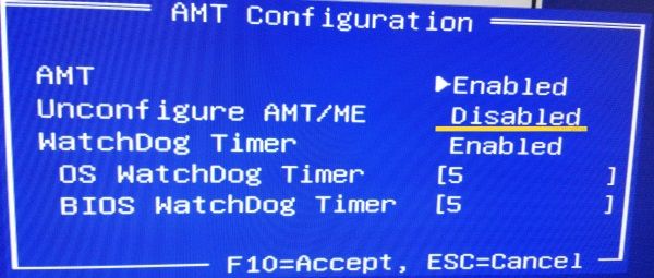

 We have done provision by using Intel Vpro on them but we dont have provision password anymore, therefore we have unconfigured via HP bios utility tool. When we restart computer, there is a massage like ““Found Unconfigure Of Intel Me Continue with Unconfigration (Y/N)” on the screen . We would like to know if it automaticly passes it with yes.

“Hp bios utility Configuration” of the BIOS from Amt - Unconfigure AMT / ME - I do Enabled.
Then when I restart it asks a question you sure you do not make you do it somehow automatically.
I need to do this operation because I need to do a lot to automize the computer.

Joseph_O_Intel1
6,323 Views
Hey Armagan
Thanks for the screen shots, Intel does not have a tool that would automate the acceptance of the unconfiguration option in the 2nd screen shot. You might check with HP they might have something but unlikely.
As to recovering a lost password, there is no solution other than a doing a hard reset. To do that requires removal of the CMOS battery.
