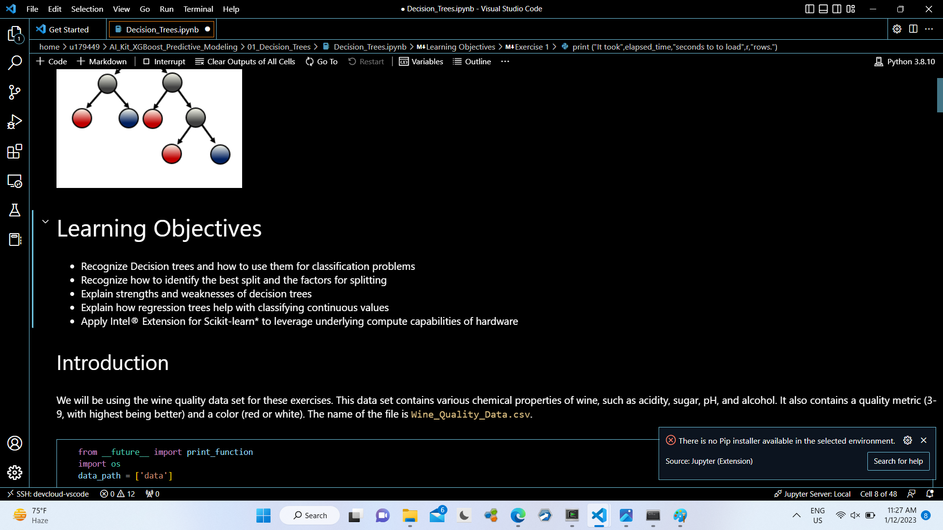

Now, when I try to connect to devcloud I get the message mentioned in the screenshot below.

Hi Alekhya ,
Thank you for helping me out.
1) I'm not connected to a VPN but there is a college proxy I must log into first. No , ssh devcloud.proxy did not fix my issue.
2) I am able to access terminal ssh using my mobile data but still cannot access the Jupyter Lab.
3) I think I'll have to add proxy related info as suggested by the manual configuration guide.
This is the link for the login - http://192.168.254.1:8090/httpclient.html .
I'm not sure what the proxy name should be according to the guide. I've tried 92.168.254.1:8090 but it doesn't work.
user_id : u150982
Thank you
