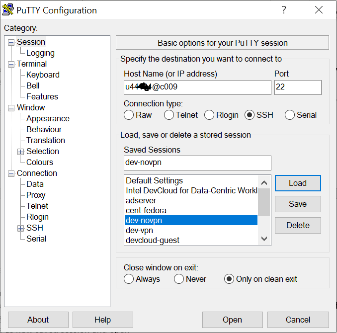

For some reason I no longer see connection instruction for Windows via PuTTY in DevCloud setup page. I am trying to connect via PuTTY while inside Intel VPN. how can I gain access to the information I need?

Guest session is used as a gateway while connecting to devcloud. In order to connect to devcloud without VPN , please follow the below steps:
1.      Use the same configuration of dev-guest under the “session” category and change the proxy type to “None” under the ConnectionàProxy category [ Refer image 1 and 2 ]
Save as new saved session and open
2.      Use the same configuration of dev-vpn under the “session” category and change the Telnet command / local proxy command to "C:\Program Files\PuTTY\plink.exe" -load [name of the session created in step 1] -nc %host:%port  under the ConnectionàProxy category [ Refer image 3 and 4 ]

You can follow these steps to connect to DevCloud via putty under closed internet connection or proxy:
1)     Load your DevCloud access key to pageant
2)     Create a session ‘dev-guest’ in PuTTY with below configuration .
Under ‘Session’ on left category bar :
Hostname : guest@devcloud.intel.com , Port : 22
Connection type : SSH
Under ‘Connection’à’Proxy’ on left category bar:
Proxy type : SOCKS 5 , port : 1080
Proxy host name : proxy.jf.intel.com
Local proxy command : connect %host %port\n
3)     Save and open
4)     Create another session ‘dev-vpn’:
Hostname :uxxxxx@c009 , Port : 22
Under ‘Connection’à’Proxy’ on left category bar :
Proxy type :Local, port : 80
Local proxy command : "C:\Program Files\PuTTY\plink.exe" -load dev-guest -nc %host:%port
5)     Save and open to connect to DevCloud.
If you have any further issue, please let us know.

Thank you. I figured it out. I can access using PuTTY's vpn session. Accessing via guest session is still being troubleshoot. I suppose that is for accessing when VPN is not active. But not able to get it to work.
I do see the vpn session actually calls the guest session and it works fine. So, there is one purpose for the guest session. But it would be good if I can get it to work outside VPN.
