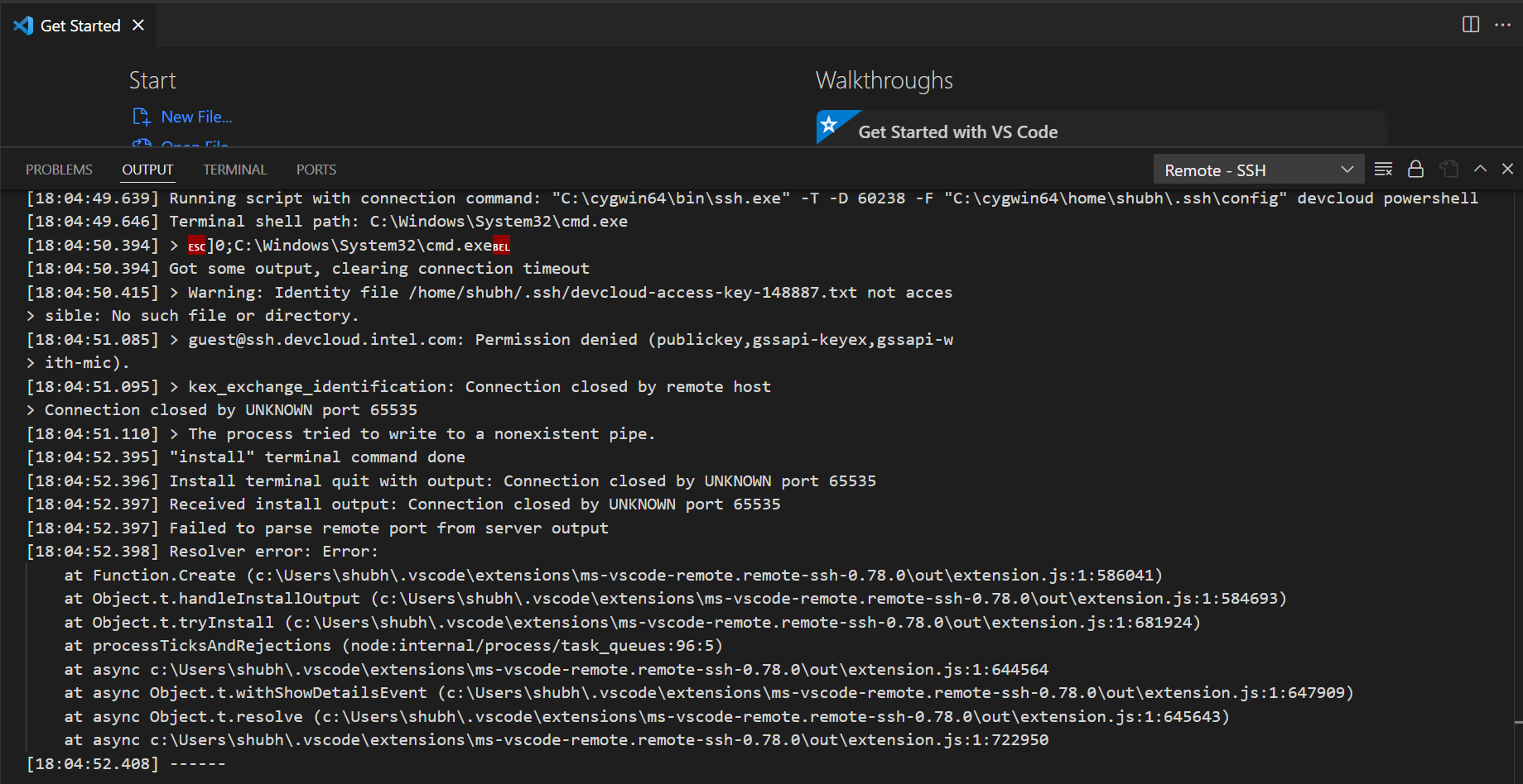

I am unable to figure out even after following all the steps (https://devcloud.intel.com/oneapi/get_started/baseToolkitSamples/) that I cannot able to connect to Intel Dev Cloud with VS code.
It shows the error as attached in the VS Code terminal. Could anyone help me out with this?

From the screenshot provided by you, we observed that there is a permission denied error.
Please reconfirm that you have set the correct restrictive permissions on private SSH key and on the SSH client config file.
You can find in https://devcloud.intel.com/oneapi/get_started/baseToolkitSamples/
1.2 Using Visual Studio Code* with DevCloud -> Option 2: Manual Configuration ->Step 3
