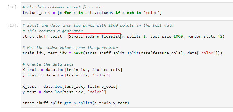

I am trying to run a command from Intel sample python notebook and facing an error, as shown in the screenshot below. Please let me know how to resolve this error.

The notebook that you are referring to is an exercise notebook. You are expected to understand the concepts and fill out the "xxx" or "x" with the required module, function, or variable names. We tried completing the notebook and there were no errors.
For example, in the screenshot that you provided, replacing the "xxx" with the module name "StratifiedShuffleSplit" will yield the correct output (Refer screenshot):
strat_shuff_split = StratifiedShuffleSplit(n_splits=1, test_size=1000, random_state=42)
