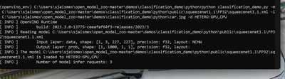

I'm currently experimenting with heterogeneous compilation. I noticed that the documentation on heterogeneous execution mentions being able to visualize model graphs with this mode.
However, I'm not sure how to "enable OPENVINO_HETERO_VISUALIZE"? I tried setting this variable via export OPENVINO_HETERO_VISUALIZE=True in my terminal but it didn't change anything.
I tried googling this further but came up with no results. I'm using the method provided on this page:

Generally, Heterogeneous execution can be used with the -d argument.
We'll get back to you with more details regarding OPENVINO_HETERO_VISUALIZE execution.
Cordially,
Iffa
to enable the OPENVINO_HETERO_VISUALIZE, you need to set this variable to a certain value which you may refer to this code
e.g.
export OPENVINO_HETERO_VISUALIZE=1
