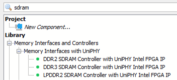

I'm having trouble to initialize the external SDRAM on the DE10-lite board.
I tried to use the SDRAM Controller Intel FPGA IP which was available for free in qsys until Quartus 20.
Now it seems not to be free anymore and I have trouble using it anyway.
My question is: what would be the *free* way to use the SDRAM without having to write a whole controller on my own when one wants to use the latest Quartus lite version?
I searched for "SDRAM" in the IP components and found that:
It doesn't look like it contains a compatible tool for me or I don't understand them.
Is there any guideline on how to use either one of these tools or the "old" SDRAM Controller in combination with the sdram that is attached to the de10-lite board?

Hi Tim,
The MAX 10 device does supported DDR3, DDR3L, DDR2, and LPDDR2 SDRAM.
These are the IPs available in Quartus for MAX 10 device.
Link for reference: https://www.intel.com/content/www/us/en/docs/programmable/683658/current/external-memory-interface.html
It's does support SRAM but need to use own design to interface with the SRAM devices.
That's why you don't find the SDRAM IP in the Quartus.
There is an example design in the resources section of the DE10-Lite Board.
You may start to test with that design.
