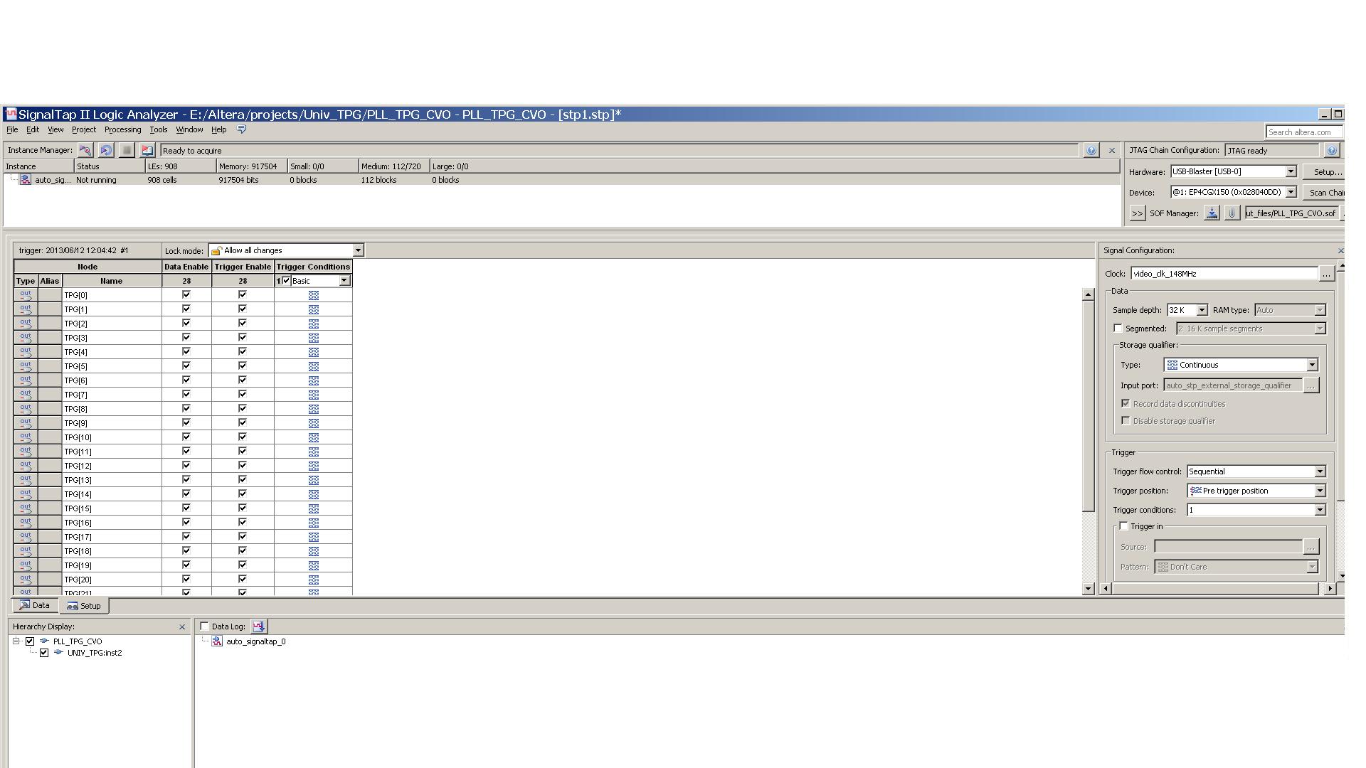

Did anyone tried to use Test-Pattern Generator IP from Altera University Program (UP) Video IP cores?
Does it produce still or moving picture?
What is the maximum clock and Frame Resolution?
I tried 1920x1080 @ 148,5 MHz, but Test-Pattern Generator IP did not produce anything valid according to Signal Tap II...

Do you have some other IP behind it which takes the picture made by TPG? Because the Avalon-ST protocol says, that the source should only send data, if the sink sets ready to 1.

Here is BDF screenshot attached.
https://www.alteraforum.com/forum/attachment.php?attachmentid=7365
Did You mean, that I should use "video_test_pattern_0_avalon_generator_source_ready" ?
I now noticed, that it is an input, although it is located on the output side of TPG BSF block.
But leaving it unconnected or connecting in to "1" makes no difference.
With Signal Tap II I see:
https://www.alteraforum.com/forum/attachment.php?attachmentid=7366
Are You sure, that Test-Pattern Generator IP from Altera University Program can produce colorbars?
Did You try it by Yourself?

Like in [1] declared, you need to set ready to one, to start the data transfer, or to stop it.

Could you test, what is on the other wires of the Avalon-ST bus?

Here it is.
https://www.alteraforum.com/forum/attachment.php?attachmentid=7367

Could you also post your trigger conditions from the SignalTap Setup-Page?!

Trigger conditions from the SignalTap Setup-Page are in default setting - the same I used when examining TPG from VIP.
https://www.alteraforum.com/forum/attachment.php?attachmentid=7370

Ah, one more thing.
You have connected the reset input from the TPG to GND, but in the bdf the reset input looks like reset_n, what would say, that your TPG is always in the reset...
Check this please!

That`s right! I followed the style of Reset in VIP TPG and overlooked , that UP TPG had a Reset of negative polarity.
Now its OK!
