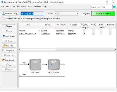

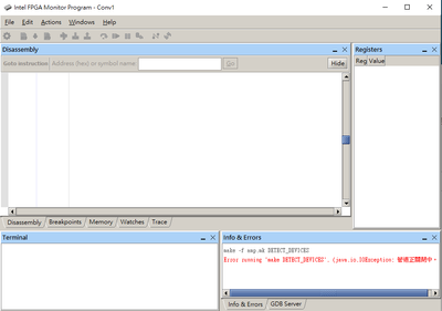

I am a DE10-nano user. I am using Quartus prime lite 21.1, and I am working on an Intel FPGA monitor program tutorial.  In the project creation stage, an error message appears stating that "Error running 'make DETECT_DEVICES'. (java.io.IOException...) "(picture above).

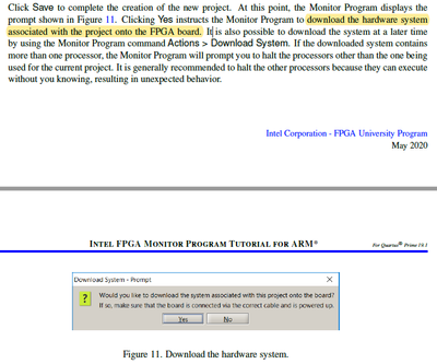

It seems to download the hardware system associated with the project onto the FPGA board(tutorial crop. picture below). I am sure that the USB-Blaster cable is already recognized.
However, when I click YES, I wait a long time.
I don't know what I can do. Is there any HW/SW configuration I don't set?

Can you program the FPGA with simple design using JTAG via USB Blaster II programming cable?

Just want your confirmation, other than the error message you provided in the first post, is there any other error seen in your side?
Aqid Ayman

No,
Just the error message in the first post.
BTW, I was following the pdf, Intel FPGA Monitor Program Tutorial for ARM*.
