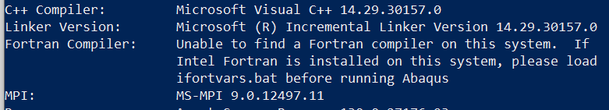

I installed intel-fortran-essentials-2025.0.0.301_offline.exe in my PC to be linked with Abaqus 2023.
In abq2023.bat, I included the following first two strings:
@call "C:\Program Files (x86)\Intel\oneAPI\setvars.bat" -arch intel64 vs2019
@call "C:\Program Files (x86)\Intel\oneAPI\compiler\2025.0\env\vars.bat" -arch intel64 vs2019
setlocal
set ABA_DRIVERNAME=%~nx0
"C:\SIMULIA\EstProducts\2023\win_b64\code\bin\SMALauncher.exe" %*
endlocal
I also made some adjustments in the system environment variables, in Abaqus CAE and Abaqus Command batch files as follows:
In the system variables, I added:
C:\Program Files (x86)\Microsoft Visual Studio\2019\Community\VC\Auxiliary\Build
In Abaqus CAE batch file, I modified to:
"C:\Program Files (x86)\Intel\oneAPI\compiler\2025.0\env\vars.bat" -arch intel64 vs2019 & C:\SIMULIA\EstProducts\2023\win_b64\resources\install\cmdDirFeature\launcher.bat cae || pause
In Abaqus Command batch file:
"C:\Program Files (x86)\Intel\oneAPI\compiler\2025.0\env\vars.bat" -arch intel64 vs2019 & C:\Windows\System32\cmd.exe /k
In abaqus_v6.env file, I added the two following strings at the end:
compile_fortran += ['/names:lowercase',]
link_sl='LINK /NODEFAULTLIB:LIBCMT.LIB /dll /def:%E /out:%U %F %A %L %B'
However, when I verified with abq2023 info=system command, it shows linking to compiler C++ instead of Fortran as in the following message
I have tried with other Intel Fortran Compiler as well such as
intel-fortran-compiler-2025.0.1.40_offline.exe
w_BaseKit_p_2024.2.1.101_offline.exe and intel-oneapi-hpc-toolkit-2025.0.0.822_offline.exe
And I also tried with Abaqus 2020.
All produced the same results.
Could somebody help me, please. I am really thankful.

I agree with Steve, you need to talk to Abaqus to learn how they recommend using the Intel Fortran Compiler, ifx, version 2025.0.
Perhaps they have a way to inform their "launcher.bat" to use 'ifx' instead of 'ifort' for the name of the compiler.  Examine that .bat file to see how it referrs to the compiler.
I don't recommend this particularly, but one COULD fool Abaqus by going to folder C:\Program File (x86)\Intel\oneAPI\compiler\latest\bin and copy ifx.exe to ifort.exe.  I really do not recommend this and it may not work.  Ideally Abaqus should have a solution for you.

I don't see that message as indicating anything other than which tools it found on your system. There really isn't a concept of "linking to compiler C++". What I do see is that the Abaqus script wasn't able to find a Fortran compiler, but I don't know how it looks for one. In particular, it needs to use the ifx command rather than ifort. You'll have to figure out how to do that.

Ron, you are great. Finally I made it with ABAQUS 2024. Here is what I did:
"C:\Program Files (x86)\Intel\oneAPI\setvars.bat" & "C:\Program Files (x86)\Intel\oneAPI\compiler\2025.0\env\vars.bat" -arch intel64 vs2019 & C:\SIMULIA\EstProducts\2023\win_b64\resources\install\cmdDirFeature\launcher.bat cae || pause
"C:\Program Files (x86)\Intel\oneAPI\setvars.bat" & "C:\Program Files (x86)\Intel\oneAPI\compiler\2025.0\env\vars.bat" -arch intel64 vs2019 & C:\Windows\System32\cmd.exe /k
In C:\Program Files (x86)\Intel\oneAPI\compiler\2025.0\bin, change all ifx.exe and ifx.cfg to ifort.exe and ifort.cfg
Run the Abaqus Command batch file in C:\ProgramData\Microsoft\Windows\Start Menu\Programs\Dassault Systemes SIMULIA Established Products 2024
In checking with abaqus info=system command, it was properly linked. And, they passed both the abaqus -user_std as well as abaqus-user_exp tests.

I thank Steve and Ron for their thoughts. I changed the ifx.exe and ifx.cfg to ifort.exe and ifort.cfg. In checking with abq2020 info=system command, it seemed to be properly linked. However, they didn't pass the abq2020 -user_std as well as abq2020 -user_exp. Anyway, I really appreciate your efforts; and, at least now I know that there will be a lot issues due to this change to the other applications that require Intel Fortran Compiler  (Abaqus, ANSYS, etc).

I followed the same steps as you mentioned in the posts above. However, for my case also, checking with abaqus verify=user, it shows that Fortran 2025 compiler is linked, but it fails abaqus verify -user_std. I am unable to resolve this issue.

I posted a solution. You have to change the win86 configuration for for Fortran compiler. Then it should work.
Edit: you should try to run a file, because this Abaqus info=system is looking for an old Fortran compiler, but we would like to use the ifx compiler (normally). If you compile a file, then you will see, that it is using the newest (2024 version) that is currently working, that I know.
