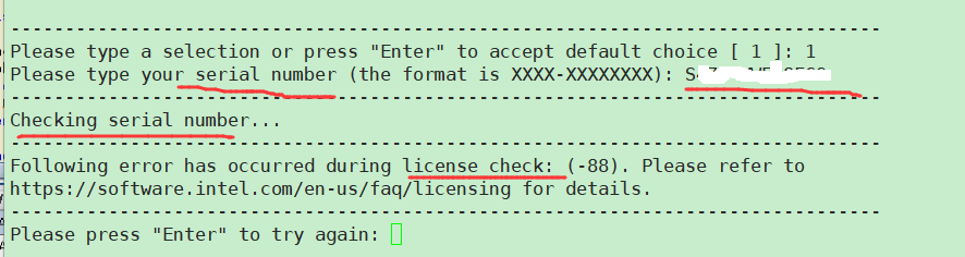

I am a graduate and wanna install Parallel Studio XE (student license) for academic purpose in my linux server. However, a strange error (-88) occurred during license check for both license file and serial number activation (as attachments).
Thanks sincerely for help.
The text for FlexLM error -88 is "System clock has been set back."
Check that your PC clock has been set to the correct date and time.
Check if your license has an expiry date or is a permanent license. Compare the expiry date (if any) with the current date.
