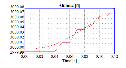

From comparing the results of the CVF and XE versions I see that the CVF application is more precise.
It looks like in CVF there are more significant digits (or half digits).

CVF did not use SSE instructions for floating point - it used the X87 registers and instructions. Sometimes this would keep intermediate results in "higher than declared" precision, leading to the effect you noticed. It was not something you had any control over, though.
If you need better precision then you should do key computations (if not all of them) in a higher precision data type/

You are right of course that when the computation are complex the precision on the X87 single is not consistent - depends of the usage of the X87 registers.
My software is made of large number of quite simple formulas so it is less relevant to me.
I took some atmospheric formulas, integration and linearization routines and converted them to double precision.
The CVF results (single) were much closer to double. In system linearization the differences were rather large.
Looking on state variables like altitude it is obvious that the the granularity of the smallest changes in CVF are much smaller than in XE.

The use of extended precision in CVF should be mostly matched by 32-bit ifort with setting of IA32 instruction set.  As these applications are normally run with x87 precision set (by default with CVF and ifort) to 53 bits, it is equivalent to promoting intermediate calculations with REAL(x,REAL64) or, in F77, dble().  As Steve pointed out, you have no control over where CVF or ifort do this automatically for the "IA32" target,and ifort may not exactly match CVF.
If you wish to take the trouble, you may insert explicit promotions in your code for each expression involving 3 or more operands.  Due to the mixed data type promotion rules of Fortran,  one insertion of dble() will take care of a 3 operand expression in some cases (like A*REAL(X,REAL64)+B). Of course, this REAL64 (if you don't define it yourself) depends on USE ISO_FORTRAN_ENV, which ifort has supported in recent years.  You could make up your own named module or internal function to abbreviate the verbose REAL intrinsic while improving future portabiity compared with DBLE(). Then you could expect portability to Intel64 targets.  It may be necessary, or at least helpful, to declare all local scalar variables as REAL(REAL64).  REAL(8) would work with ifort compatible compilers, but it is poor style.
When using simd instruction sets, which you probably are doing, as ifort defaults to /arch:SSE2, mixed single and double precision are likely to reduce performance, hence the preference of previous replies to suggest full doube precision.

Above you can see the diffrence between the two compilers. The XE results were with arch:IA32 settings.
