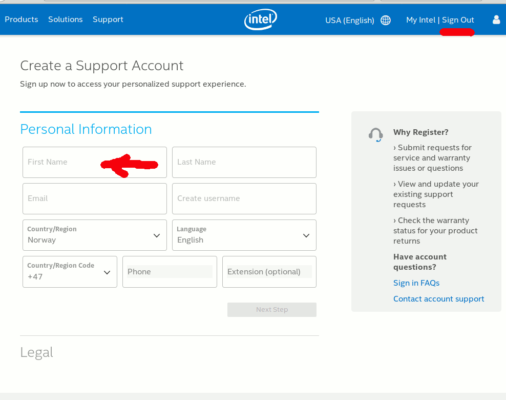

When going this link I am stuck at the 'Create a Support Account' form, here First Name etc fields are greyed out and not editable while the 'Next Step' is also greyed. This occurs in a latest Firefox:

Sergey,
I've experienced a similar situation with the registration web page. Maybe my experience relates to your situation. In my case I have two Intel accounts: 1) The one I registered the products with, and 2) The one I use for IDZ forum posts.
When I am logged in to the the IDZ site (user 2), and then navigate using the hyperlinks, the registration site shows I am not logged in. I cannot recall if the banner shows Sign Out as your screenshot shows.
If you have two accounts, I suggest signing out, then signing in again.
Jim Dempsey

Sergey,
I have sent you a message regarding your account login issue.
