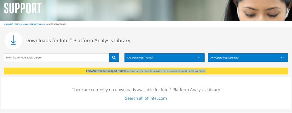

I have gone to the Intel Platform Analysis Library web page MANY times, and requested a license/download instructions, but I NEVER get a reply, and I can not find any info on the site on how to download it.
Is this a dead project, or is Intel just awful at responding to requests???
Hi Russ,
This forum is for questions relating to Intel® GPA. I, unfortunately, do not have the answer to your question because of that reason. However, from looking around on the Intel website, it seems as though they no longer have support for the product.
You can still download the metrics framework from the form you filled out (a link pops up after you approve the EULA). If you do want to double check with some other engineers, there is a premier support service that is actively monitored. The forums, for some products, are not as actively monitored by Intel® engineers and you may have better luck using the premier support services.
