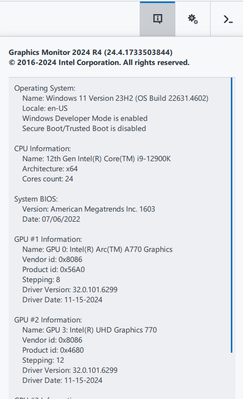

I have this same problem. Newest version from download page(24.4.1736876343) doesn't fix this issue. I tried some solutions from forum, but without success. Version 2024.3 worked without problems. GPA generate dumps files In Documents folder for every second. This is infinite loop to end space on disk drive.
HI Dawiduser143,
Thank you for your post, and I'm sorry to hear that you have been having issues opening Intel GPA Graphics Monitor.
Could you share some information to help us better diagnose this issue?
- The System Analyzer information (accessible using the (i) icon in the top right hand corner of the screen, see picture below but for System Analyzer instead of Graphics Monitor)
- MonitorConfig.json file from default Capture Files Location folder, usually it is C:\Users\<USERNAME>\Documents\GPA
And you've mentioned you've tried some solutions on this forum. Have you tried the spreg.exe workaround (Solved: Constantly notified of Graphics Monitor Server crashing), or deleting MonitorConfig.json as well as the registry entries Computer\HKEY_CURRENT_USER\Software\Intel\[Graphics Frame Analyzer, Graphics Monitor, Graphics Trace Analyzer]?
"GPA generate dumps files In Documents folder for every second. This is infinite loop to end space on disk drive."
Could you tell me more about this issue as well? Is it generating dump files constantly until Graphics Monitor is closed?
Spreg.exe doesn't work. Permission denied and system only show message like on the screenshot. I'm working on administrator account permissions. Delete registry files do nothing. Change "\" to "/" line "C:\Users\river\Documents\GPA in MonitorConfig file also doesn't work. "Is it generating dump files constantly until Graphics Monitor is closed?" - no, only when turn on the program, this is infinite loop when program is running. 2024R3 works without any problems, also with disabled developer options, but R4 brings only new problems on my device.

Apologies - it turns out that the January hotfix was for a separate issue and did not include the fix for Graphics Monitor Sever crashing. A fix for this issue is targeted for the upcoming 25.1 GPA Release.
Thank you for the additional information and clarification. Could you try this workaround?
- Navigate to your GPA install directory (C:\Program Files\IntelSWTools\GPA)
- Delete the following .dll files: EMONPlugin.dll and NPUPlugin.dll
Let me know if this works for you. And sorry about the incorrect information regarding the hotfix, I have edited my previous posts to reflect this.
Delete a EMONPlugin.dll file is resolving the problem with creating a dumpcrash files and crashing monitor server notification. NPUPlugin.dll deleted or not, it doesn't matter. Thanks for help and i am waiting for the new 25.1 GPA version.
