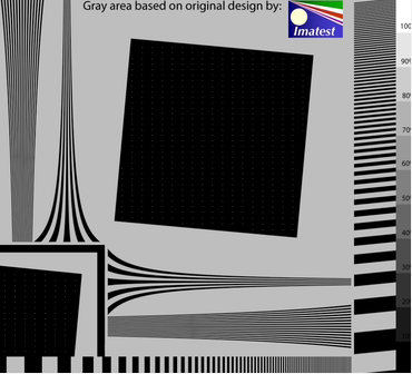

I've been using ippiResize_8u_C1R() to resize a test picture down to 37% of its original size.
The result is rather disappointing:

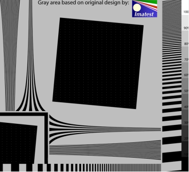

When using IPPI_INTER_LANCZOS I get the same bad image that I get with IPPI_INTER_LINEAR, though it takes about 4 times as long: ipp-resize-16.png
With IPPI_INTER_SUPER I get a somewhat OK picture, at least, although it's pretty slow (my own SSE code using the same algo is about 5 times faster): ipp-resize-8.png

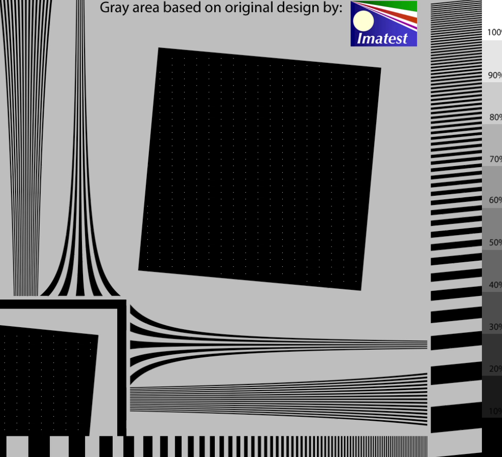

I really want to get a good quality result, though, based on Lanczos 3, as seen here: lanczos3.png
Are there any known limitations that explain why IPPI_INTER_LANCZOS does not give the expected quality?

I tried out the example provided in Vol2 of the IPP manual and found that it all works as intended by Intel: I get the results as described. So there's no reason to suspect I'm calling it in a wrong way. Plus, the parameters are straight-forward, what can be done wrong there that would lead to sensible results that just provide unsatisfying interpolation results? The code I have here is woven into quite a complex app, and unless you can hint at possible errors I could make, I find it a waste of time to turn it into a demo app that I can send you to try it out yourself - please don't take offense at that.
It's rather obvious to me that the Lanczos algo used by the Resize functions is the culprit here - it apears inferior to the one Apple provides in their vImage lib. Theirs provides a great result where there are hardly any interference patterns where Intel's shows them pretty badly, as shown in the sample images I linked to in my first post.
Here's the original image:http://www.tempel.org/pmwiki/uploads/Main/ImageScalingComparison/orig-fullsize.png
If I scale that down to any factor < 1 (same factor for X and Y), using Lanczos, I see the interference patterns. If I let my browser (Safari 3 on OSX) or Apple's vImage scaler make it smaller, those patterns hardly show, just as it's expected from a Lanczos filter. Are you sure you'd be able to get similar good results with IPP's resize function? Are there any examples to look at?
