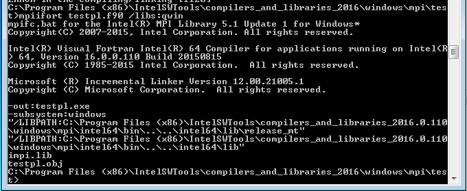

Thank you very much for your answer. I have worked with the command line execution of the test routine testpl.f90 with QuickWin graphics (attached), with a modified placement of the plotted red rectangle.. I got the following results:
1. Compiling and linking with mpiifort according to your instructions:
mpiifort testpl.f90 /libs:qwin to produce the load module testpl.exe. Works OK
2. Running the load module with mpiexec:
mpiexec -n 4 testpl
gave no output (see attachment mpiexec from the task manager) but the computations "hung up".
