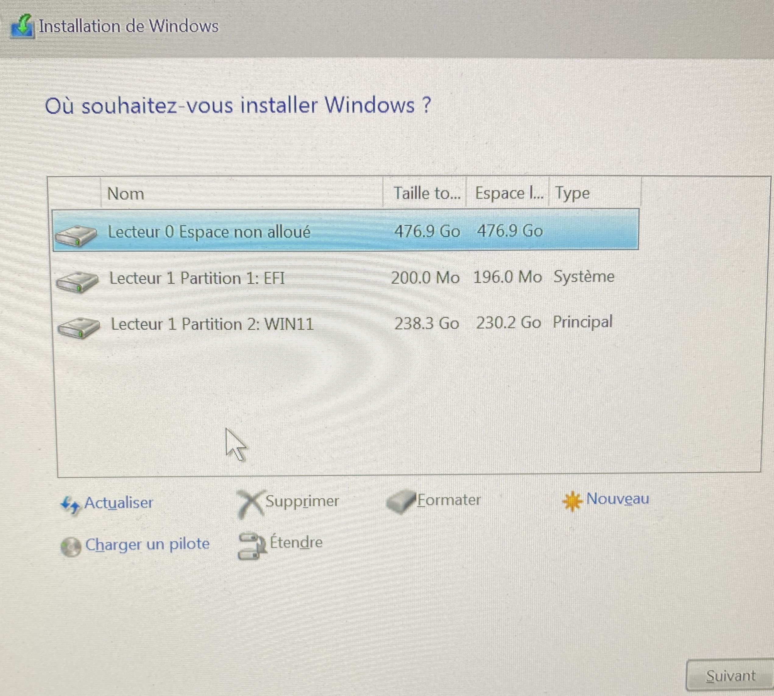

It's been a full day I'm stugling to install Windows 11 on a bran new NUC11TNKi5.
I've built the installation media, boot the Windows installer but when it comes to create the partitions on the M.2 drive, windows claims it can't create the partitions.
I can see the disk, create the partitions, but when I press the Next button, I get the following error message:
We couldn't create any partition, neither locate an existing partition.
For more information, see the installation logs.
I tried to set the UEFI Bios to its default settings and boot from the install media again, didn't helped.
Thanks for your help.

I went to Repair Menu > Command Prompt.
I typed Diskpart at the prompt and then:
> select disk 0
> clean
I now indeed see the Unallocated space.
I select the unalocated space at the installer window and when I click Next, I get an 0xC0000005 error.
1. Do I understand correctly that you have two drives in your system? Drive 0 and Drive 1?
2. Disconnect the Drive 1 (with Windows 11 already installed).
3. Restart the Windows 11 installation on Drive 0.
Leon
Drive 0 is the internal M.2 drive I want to install windows into.
Drive 1 is my Windows 11 USB-C install disk.

Dear Leon,
I created a clean Windows Installer using the Microsoft MediaCreationTool on a USB type A hard drive like instructed.
This time, the Windows installer was able to create the partitions on the internal M.2 drive.
Why the hell was this not possible using a USB-C port is still a mystery to me.
