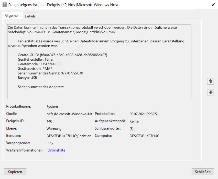

I just bought a new Kingston USB 3.2 Gen 1 pen drive and get the same error!
Attached you find the SSU file and some error msg (in German).
Looking forward to hearing from you soon!
Chris

I'm just afraid that you have not isolated the problem. And using a bad USB drive.
I hate the 'terra label. Because I think you are using terracopy to format. And maybe the drive is write protected.
From an online search. Because I do that. It appers that you have some kind of a backup setting that's causing the warning to pop up.
From the hardware error. Just look through the Disk Manager for faulty information of that USB flashdrive. Because that's what regular Windows(& windows 10) users like to do.
