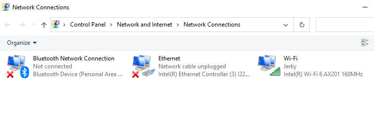

I just bought an 11th gen NUC model NUC11PAHi5 and I can't use Ethernet. The device shows up in device manager and says it is working properly, but in the Ethernet status area it says no cable is connected. The cable is connected and has been tested and works on another computer.
I updated the BIOS to 0041 and I updated the network controller driver to 1.0.2.14. It still cannot detect the ethernet cable.
I can use WiFi just fine. I also tried turning off WiFi to see if that would kick-start the Ethernet, but it did not.

I also need to add that I ended up returning the i5 again and got a refund. Then I purchased an i7, but am having the same issue.

I am not using an anti-virus. I have a clean install of Windows 10 Home. Have not installed anything else yet. So it would just be Windows Defender and whatever else comes with Windows 10 Home.
Did you remember to install the LAN driver package (here: https://www.intel.com/content/www/us/en/download/19724/intel-ethernet-lan-network-connection-driver-for-nuc11pa.html)?

I ended up returning the 11th Gen and got a 10th Gen i5 tall Chassis. I'm happy to report that the Ethernet port works great. I'm extremely glad this worked out because I have really enjoyed the NUC footprint.
