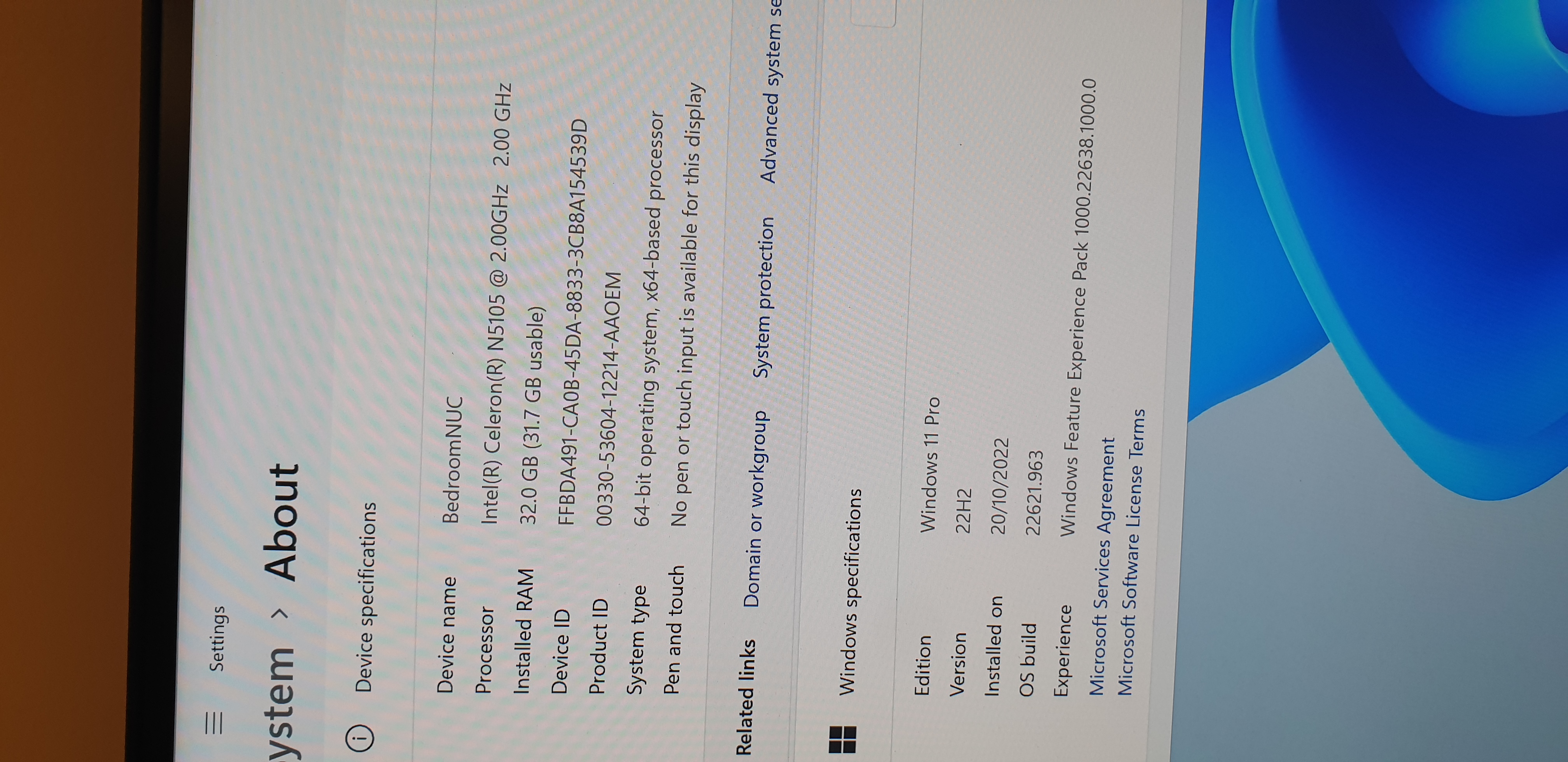

Get 2nd stick of 8GB RAM and 4K 60fps like Top Gun 4K works fine ... my same NUC is now with dual channel of 2x8GB Crucial 3200Mhz RAM that downclocked to mobo's 2993Mhz and I have HDR turned on without any issue while noting that Appearance setting is at performance.
Integrated graphic solution of such UHD is helped tremendously for struggling ones by improvement in RAM performance like dual channel configuration since RAMs arely used in conjunction with the UHD graphic for needed bandwidth.
Hope this helps anyone with the same issue .. from someone who tried and tested with real life experience.

I received the sticks today and it didn't work.
I have the Intel NUC7i5BNK with 2 Crucial 8GB DDR4 3200 SODIMM (CT2K8G4SFRA32A) which replaced my "old" Corsair 8GB ValueSelect DDR4 2133 SODIMM (CMSO8GX4M1A2133C15). I used both MPC-BE and VLC with standard parameters and tried a few tweaks but without success.
Maybe the combination of CPU and GPU is not enough for 4K rendering. I tested a movie with Dolby Vision which is supported by my Sony XR-55X94J. When I used my old gaming laptop with a Core i7-6700HQ, a Nvidia GTX1070 (not the laptop one) and 32 GB RAM (different sticks) it is working well without any stuttering.
EDIT:
Apparently it is due to a mismatch between the frame rate of the video and the refresh rate of the TV set. 60 Hz for the TV and 23.976 Hz (fps) for the video. Cfr. community.intel.com/t5/Intel-NUCs/NUC7i7DNHE-video-playback-stutters-at-1080P-or-2160P-Windows-10/m-p/548738#M45235
When I set the frequency of the TV set to 23.976, the stuttering disappears.
Still using the NUC. I also had flickering at times when watching content on browsers (Firefox and Chrome) and it looks like changing the HDMI cable improved the experience: I now use a StarTech 1m Premium High Speed HDMI Cable for 4K at 60 Hz (HDMMV1M).
I cannot say that the stuttering has completely disappeared but it is better too. That means that my previous attempt which resulted in "EDIT" in the previous post was not 100% successful.
