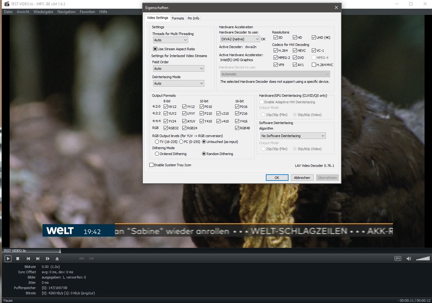

hi, i am Software Developer of a Home Entertainment System. Building own Direct Show Filters, and Player ...
I can test about 50 different hardware systems (amd/intel/ati/nvidea).
you can see the problem in screenshot - Deinterlacing.jpg (ticker is not ok).
screenshot is made with MPC-BE and LAV Decoder - every other player/decoder/renderer combination has same result if HW Deinter. is used.

Hello onursen, I just received an update on this matter.
After trying to replicate the issue in our Intel® lab, we determined:
The issue can be reproduced when using Intel® and Nvidia graphics while using these video players:
- MPC-BE
- Movies&TV
- Windows Media Player
- KMPLayer
We also tested with VLC and cannot reproduce the problem. So, this points to the root cause being the video player application that you are using.
Since the issue is reproducible on GPUs from multiple manufacturers (Intel® and Nvidia), this indicates to the issue is not been caused by Intel® Graphics Driver.
So, at this point, what we recommend will be to get in contact directly with the application’s developer for further technical assistance on this matter.

hi,
VLC uses Software Deinterlacing - there is no option for HW Deinterlacing.
https://wiki.videolan.org/Deinterlacing/
pls test with players which use HW deinterlacing.
it is not a player issue - other intel gpus have no problem.
Usually Intel HW Deinterlacing is working well (better then ATI).
regards, onbur
this issue is not fixed!
VLC and cannot reproduce the problem becouse VLC is not using HW Deinterlacing.
other Intel GPUs have no Problems.
