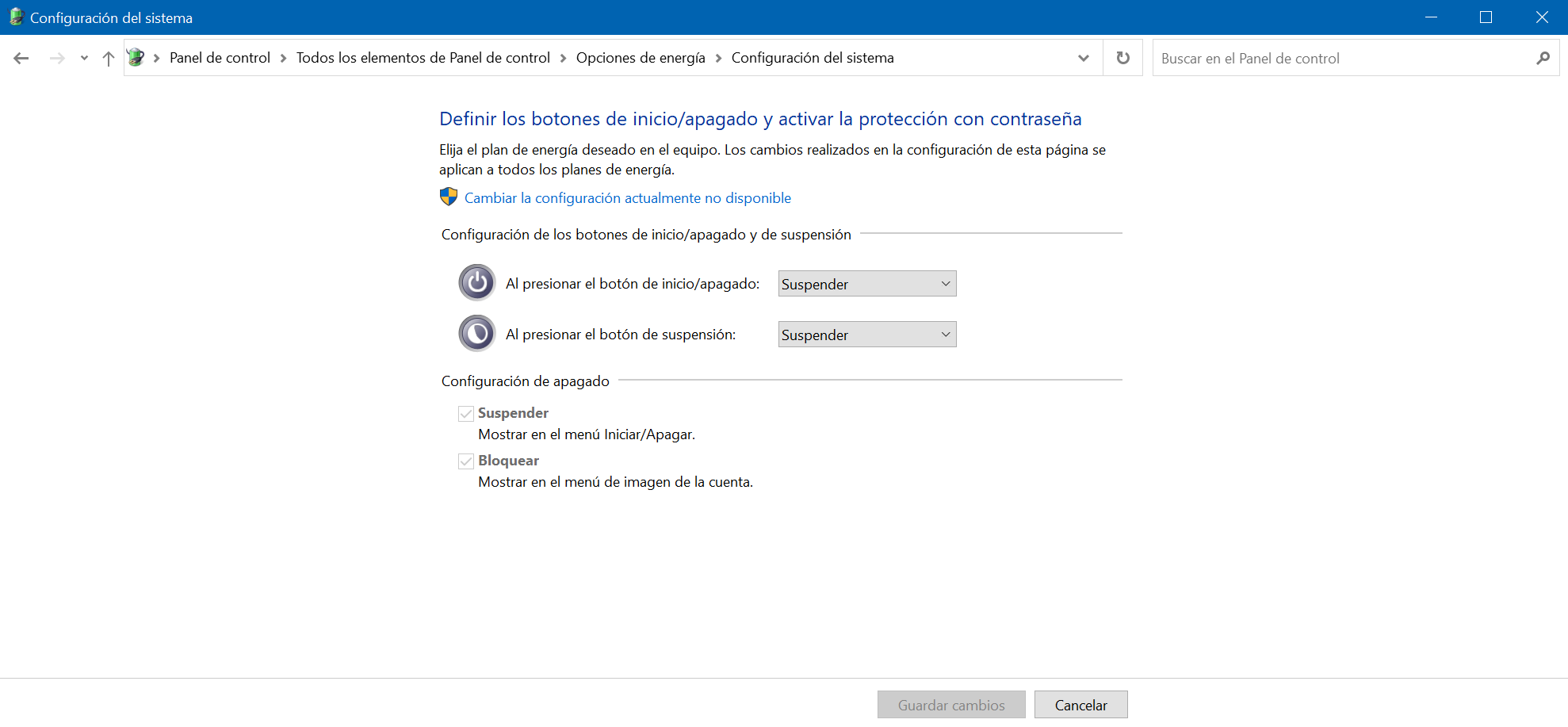

I have now discovered that suspend does not work automatically, if the screen and the computer are set to turn off in 1 minute, the screen and the keyboard light turn off but the disk, processor and ethernet activity lights on the NUC show that have activity and logically with the fans turning.
But if I force Suspend from the bottom left button /Start/Shutdown... where it says hibernate, shutdown , Suspend, then the NUC suspends and the physical power button (and skull) flashes indicating it's on. suspend mode.
I send you the SSU file and some screenshots of the power option, they are in Spanish but I don't think you will have problems understanding it.

Andrew, I had already done all the steps you indicate, BIOS update, modify the Screen and Sleep timers but without success.
But finally I have decided to do a clean install of Windows and now everything works fine.
There was some setting in windows, I guess in the registry that prevents suspend from working properly.
Thank you for your support and the incident can be closed.
