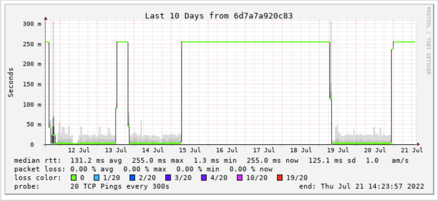

An update on the issue, with more testing, here is my observation:
1) As long as the OS is not running on NUC, AMT will stay accessible
As you can see from the attachment, the unit was stable for more than three days, from Jul.23 to Jul.26. Meanwhile, the probing response time was steady.
During this period, the host OS, in my case the PVE was not running, and I switched the power source from UPS to the wall outlet as Scott suggested.
2) AMT goes down "as expected" after the host OS ran for a while
Once the OS is turned on, you can see the AMT response time starting to fluctuate as the grey peak and trough. And then it turned inaccessible after 30+ hours.
Here is my assumption of the issue:
1. The AMT will run into an issue with the host OS turned on
2. The issue is irrelevant to simulated AC sine wave UPS
Just out of curiosity, the issue shall be very easy to replicate. I wonder why it's not reported by QA given the AMT should be a key selling point of "v" models ...

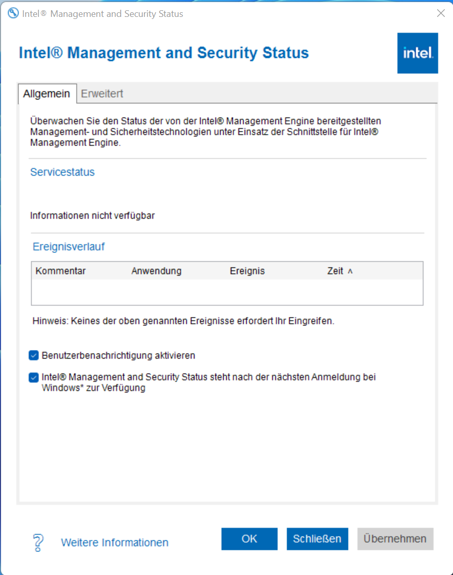

Hi Everyone,
I can confirm the same behavior of two BNUC11TNKV50Z00 with TNTGLV57.0067.
The device isn't reachable anymore per AMT after some hours. I am unable to access the AMT web interface. Also no connection for MeshCommander possible.
Moved to fan-less Akasa case, running Win10, EATON UPS Ellipse PRO 650, ACM, no TLS.
The OS, in my case Win10, is working.
A Windows restart does not help, a hard reset can fix it.
Both units have the same issue.
