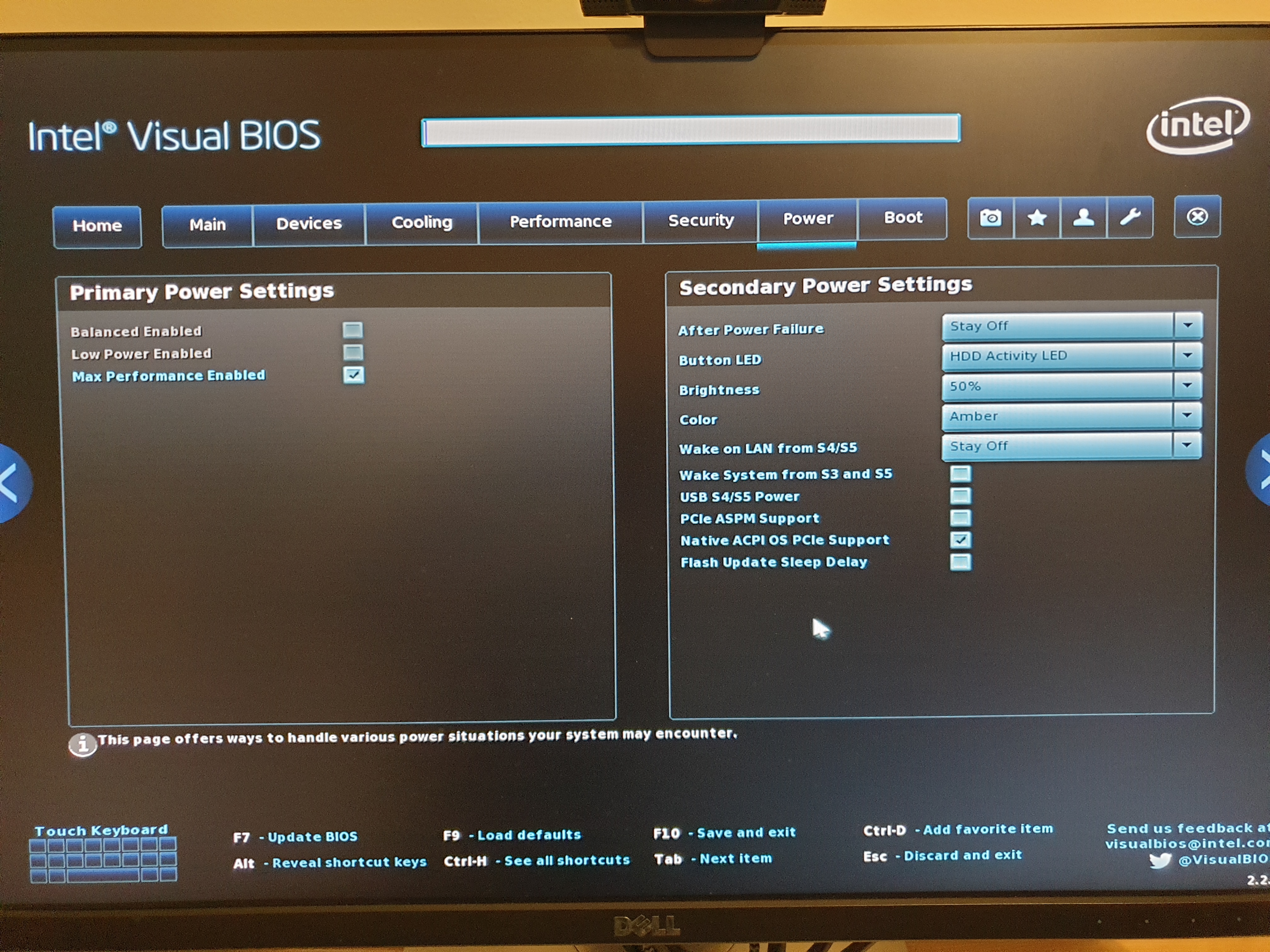

Hello Jacob,
It is something unclear in your post. The SSU report is from NUC7i7DNHE, while the BIOS image attached is not from NUC DN. Yes, I agree with you that there is no Modern Standby option in NUC DN BIOS, but as I know, there is no Deep Sleep option as well.
I'm attaching images from BIOS version 0075, taken on NUC7i7DNHE. You may see that the Power tab is completely different.
Please ensure that USB Legacy is enabled on Devices > USB tab
Leon
Dear Leon,
SSU and BIOS image are from the same NUC. I have no idea why you can't see more options.
Next time I see the NUC in person, I will check if legacy USB is enabled. Navigating the BIOS in through AMT/vPro is pain and doesn't work well.
Kind regards,
Jakob
Hello Jacob,
I think I understand now the "mystery" of differences in BIOS options. In your Primary Power Settings the Power Mode is undefined, while in my BIOS, Max Performance Enabled is checked. In addition, in the Secondary Power Settings, the Power Button LED is used differently (HDD Activity LED vs Power LED). Please see the attached video clip.
Please enable Native ACPI OS PCIe support.
Any way, in my NUC, the NUC Wake from sleep by USB device works.
Leon
Hi Leon,
you are right, our NUCs are configured to have a very low TDP so they stay quiet. I thought your were talking about the Deep S4/S5 option that was missing in your first screenshot. However it seems like it has appeared in your BIOS, it is visible in your attached video.
I will enable Native ACPI OS PCIe support as you said. In summary disabling Windows fast boot solved the issue.
By any chance, do you have experience with wake on Bluetooth, which this NUC should support? I couldn't get this working either, and rather quickly gave up on it.
Kind regards,
Jakob
Hi Jacob,
1. Deep S4/S5 option appears only if all of the Power Modes are unchecked (i.e. Balanced Enabled, Low Power Enabled and Max Performance Enabled are unchecked).
2. My NUC runs very quietly with Max Performance Enabled checked and Intel Turbo Boot Technology (Performance > Processor tab) disabled.
3. You may try to enable Low Power Enabled and see how the NUC works.
4. Paired to Bluetooth my Logitech MX Master 2S mouse. It didn't wake my NUC from S3 (although according to specification it should ) and also is not working with Bluetooth connection in BIOS. So, I'm using this mouse with Logitech Unified WiFi receiver inserted into USB port.
Leon
