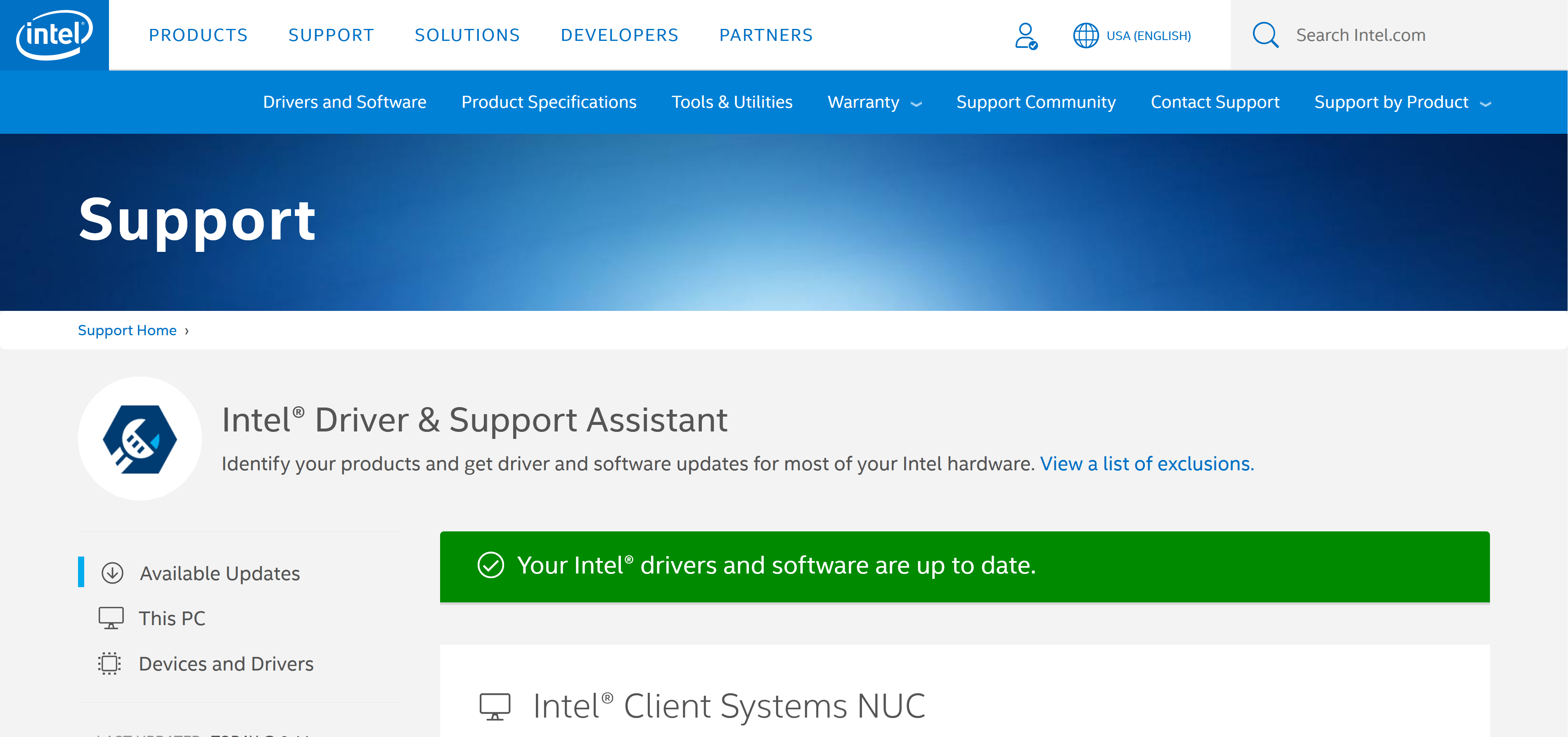

2. Do you have any problems related to the current BIOS version installed on your Intel® NUC?
3. Besides the Intel® DSA having the wrong link out to the Intel® community's website, do you have any other problem like wrong updates available for your NUC? Please provide a screenshot if that is the case.

To address your points out of order, I've noticed that your team has fixed the Support Community forum link dead-ending in relation to point 3. In regards to the IDSA misreporting available updates, I know for a fact that searching for my device, NUC8i7HVK, in general support and going to the device's driver page - https://downloadcenter.intel.com/product/126143 - has brought up drivers that were more up to date than the ones IDSA offered (or didn't offer). I don't have screenshots of this.
