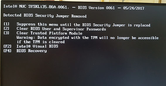

I've NUC6i5SYH, updated to SY0067. No problems at all. You wrote that you have removed jumper, but I don't know what you did after jumper removing. Try to power ON you NUC with security jumper removed and all four USB slots empty. After about 30 seconds, you shall see Configuration Menu (similar to the attached image)

Thank you for your suggestion.
I tried to power on without security jumper, with empty usb slots, with empty hdmi slot, with RAM, without RAM, with SSD, without SSD with short press, with 3 sec press and all combinations thereof. Fan does not spin, blue power led does not light up, screen shows no signal.
