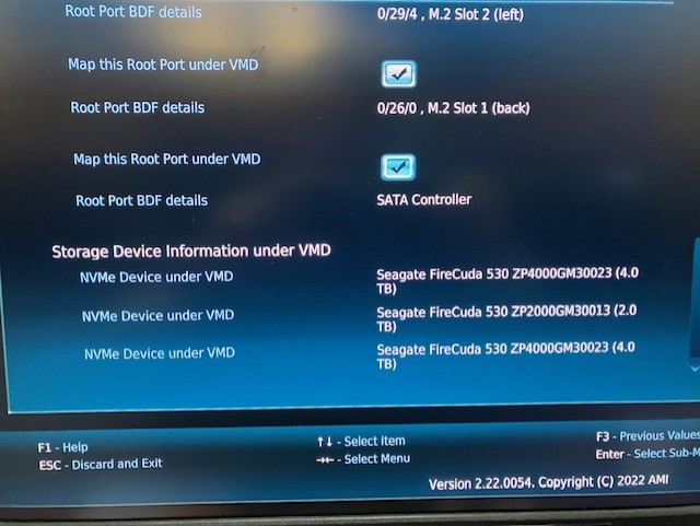

I'm trying to configure an Intel Nuc Extreme NUC12DCMv9 populating all the 3 M2 slots.
If possible the 2x 4TB at the from and the 2TB at the back.
I'm using 1x 2TB Seagate Firecuda and 2x 4TB Seagate Firecuda with no success.
Even thought that all the 3 devices are shown on the BIOS, as soon as I try to install Windows 10 or Windows 11, only 2 of these are seen either on the Windows setup, either after Windows installation.
Already try to rotate the drives on the slots on all possible combinations.
No matter what I do, only 2 are seen at a time.
Even when 2 devices are seen, they appear randomly, sometimes ones, sometimes others.
Sometimes is the drive on the left slot unseen, sometimes the one at the right slot, and even happened the one on the back not seen.
NUC12DCMv9 is updated to the latest BIOS and have 64GB of memory.
Using Windows Device Manager, 3x Standard NVM Express Controllers are present, but one of these presents an exclamation mark.
It says:
"This device cannot start (Code 10)
An I/O adapter hardware error was occurred"
Tried with SATA enabled and disabled on the BIOS but the problems still there.
Is my NUC12DCMv9 broken? What can I do to solve this problem?

I went into BIOS and, under STORAGE, I checked every box.
After that I was able to instal the Intel RST and after a Reboot, all the 3 drives come on.
On Device Manager, instead of the Microsoft Standard MVM Express driver, now are present 3 Intel based drivers, one for each drive.
This was done on a trial and error basis and I do have no idea if I should uncheck any of the boxes...
The NUC is a brand new one and before this "solution" every slot worked but only one or two drives were seen at a time.

Yes, after checked all storage option in the BIOS I was able to install The Intel RST.
I did it, not because I wanted to create or use any kind of RAID, but as a trial and error until the Microsoft Standard MVM Express drivers were substituted by the Intel ones. There might be a different way to accomplish it, but that was the way I was able to do.
Before installed RST I had no chance to have the Intel drivers installed. Maybe a coincidence, no idea.
With these Intel RST drivers all 3 drives are shown and working.
I do not want to use any kind of disk array.
I have no idea if I should uncheck some of the Storage options.
Please find attached photos of the BIOS under the Storage tab. Also enclosed a picture of the actual working drivers under Device Manager.

After investigating this, we don't see any reason why RAID needs to be enabled for the 3 drivers to be recognized in Windows*.
If the 3 drives are recognized in BIOS, the operating system (OS) should be also able to map out the drives, perhaps not during Windows setup but for sure under "Disk Management".
The non-RAID mode (SATA mode) should be configured as follows:
Do not enable VMD controller if RAID is not intended:
We would recommend the following:
1- Try one drive and install the OS.
2- Add the second drive and map it using "Disk Management".
3- Run some Drive testing/stress.
4- Check if no issues are detected.
5- Add the third drive.
If the system stops recognizing any of the drives randomly, please let us know and provide us with details of the outcome of the steps.

I had this same issue with my NUC 13 Extreme i9. My NUC could never see the CPU M.2 slot. Which I would guess is the same issue you were having. I had to enable VMD and map the M.2 in Bios to get it to read in Windows.
Cheers
Bill
Same solution here.
Thanks for sharing.
