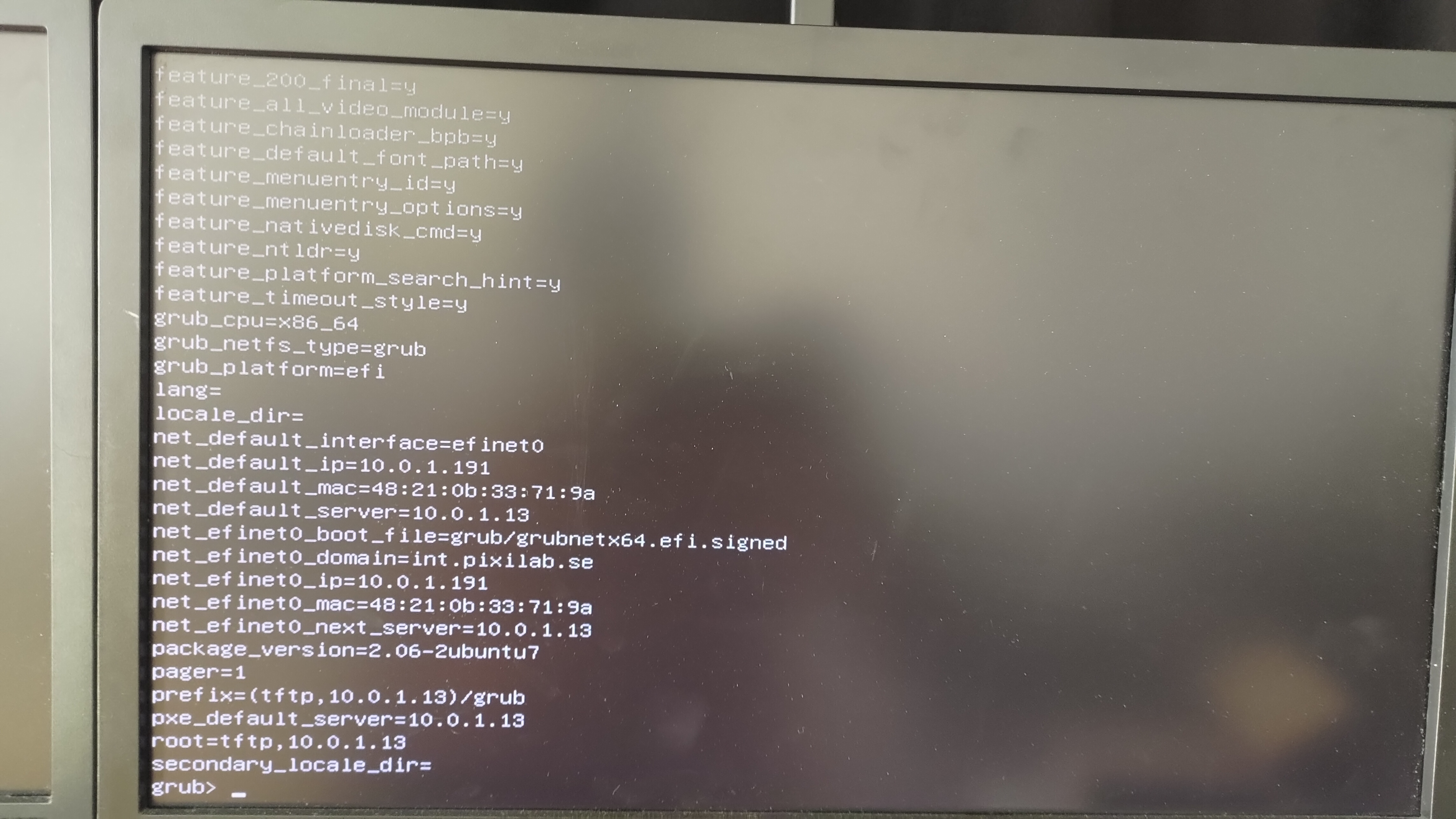

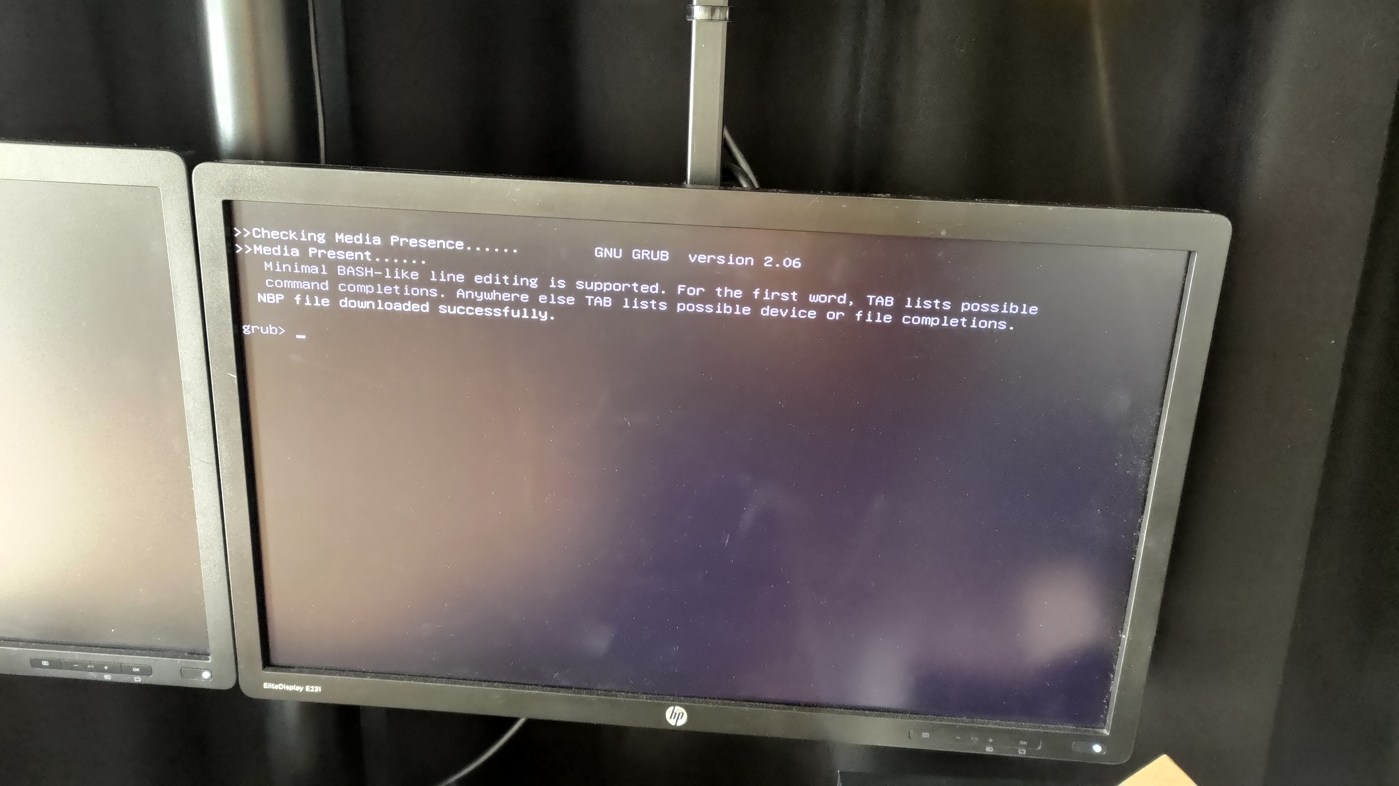

4.) I have attached an image showing the halted grub (the one ending 075719.jpg). . So we end up in the GRUB shell. Shell is working just as it should with the exemption that i cannot fetch the grub.cfg from the tftp server.
Also attached the response if i type "set" to show grubs current configuration. (080309 and 080246)
If i at this stage type: configfile $prefix/grub.cfg we would on a working system move on and boot the system with the settings provided in the grub.cfg but on a failing device we will get a black screen for about two seconds and return back to the grub shell.
If i hook up wireshark to the tftp server I can conform that on a failing device, no attempt to fetch grub.cfg i made. On a working device, we would see a fetch of grub.cfg.
My theory is that something with the network fails when grup is executed. We always see a successful fetch of the grub NPM package, but after executing it we seem to loose the ability to fetch over tftp and http.
Also attach one video where manually fetching the grug.cfg on a working NUC (video 083122) and one trying after the NUC failed to shell. (video 083145).
Let me know if you would want me to test something in grub shell paerhaps to get some lead in what is going wrong.
