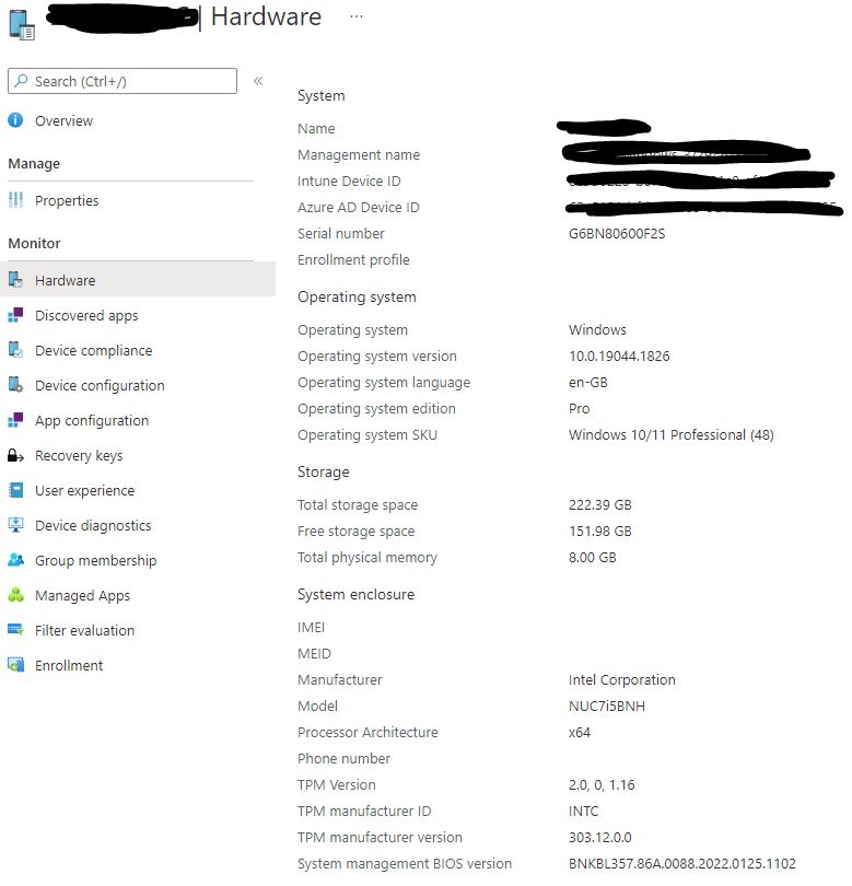

I have a customer with 3 Intel NUCs that are reporting to be NUC7i5BNH
I am needing to enable Bitlocker on all their computers but these 3 Intel NUCs (above mentioned model) are not able to enable Bitlocker with TPM.
The Intel ARK states this device does not have a TPM, but this does not appear to be the case when I query this on the device itself, how can this be?
Here is the output from the device showing it has TPM;
C:\WINDOWS\system32>wmic /namespace:\\root\cimv2\security\microsofttpm path win32_tpm get * /format:textvaluelist.xsl
IsActivated_InitialValue=TRUE
IsEnabled_InitialValue=TRUE
IsOwned_InitialValue=TRUE
ManufacturerId=1229870147
ManufacturerIdTxt=INTC
ManufacturerVersion=303.12.0.0
ManufacturerVersionFull20=303.12.0.0
ManufacturerVersionInfo=Intel
PhysicalPresenceVersionInfo=1.3
SpecVersion=2.0, 0, 1.16
Have also attached 2 screenshots of the device in Microsoft Intune/Endpoint Manager showing the Bitlocker Encryption not working and some details about the device according to Intune
