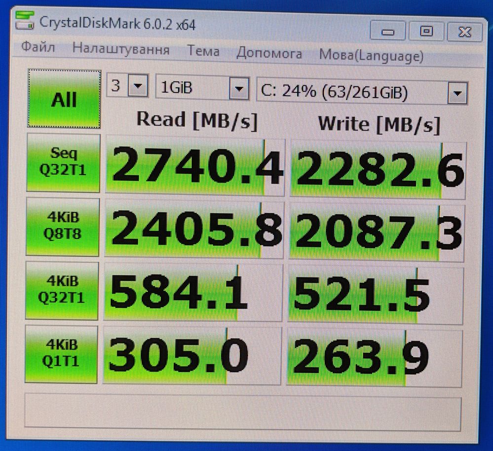

I have intel optane 900p 280GB installed to PCIe x16 (CPU) slot.
The problem is that in Windows 10 64bit (clean install) in a different benchmarks, results up to twice worst in a random read/write and latency than in Windows 7 64bit (clean install).
I have made a lot of tests! Install, reinstall drivers, updates, changing setting in bios, but result every time the same.
Now I have two OS (with latest intel nvme drivers, fully updated, latest MB drivers) on intel optane ssd, win10 and win7, and made screenshots of benchmark.
What is wrong with Windows 10?

I did a bunch of testing a while back on Optane in and out of VROC setups comparing systems with Specter and Meltdown on and off and determined that Optane is extremely sensitive to these patches in terms of 4KQ1T1 speed.
If I were you I would try disabling Specter and Meltdown mitigation and testing again on Windows 10, I suspect that you will see a huge improvement.

Hello BHarr8,
Yes, it's true, patches impact to ssd performance,
I have installed win 10 two years old .iso that doesn't contain that patches and made tests, the differences is huge.
But win 7 without patches still have better performance.
Both screenshots is without Specter and Meltdown patches, Top - win 7, Bottom - win 10.900p_win7_wo_patches.jpg900p_intel_drv_win10_wo_patches.jpg
