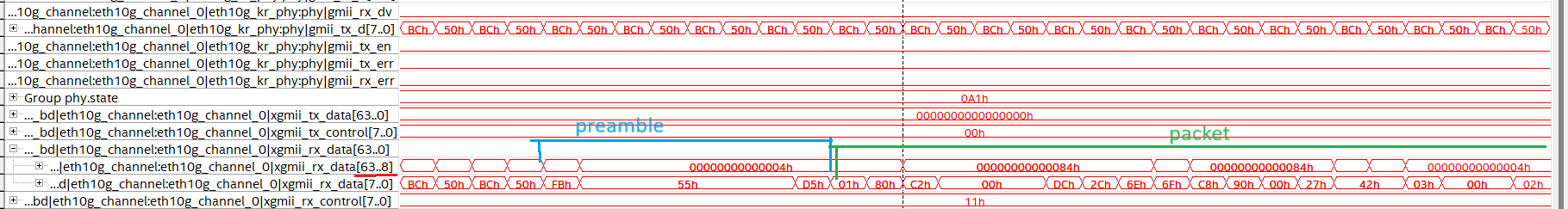

Hello, all.
I attempt to launch the Ethernet 1Gb link through the 1G/10Gbe and 10GBASE-KR PHY Intel Arria 10 FPGA IP.
1Gb patch-cord connects SFP+ port from board with Arria10  with SFP+ port on Mikrotik router.
On Mikrotik SPF+ port  Auto-Negotiation is disabled and only speed 1Gb is enabled.
Configuration of 1G/10Gbe and 10GBASE-KR PHY IP is:
IP variant: 1G/10Gb Ethernet
Initial datapath: 1G
tab 10M/100M/1Gb Ethernet -> Enable 1Gb Ethernet protocol = enabled
tab Speed detection -> Enable automatic speed detection = disabled
1G/10Gbe and 10GBASE-KR PHY IP asserts rx_syncstatus and led_link, because accepts BCh 50h pairs.
Router also established link (see attachment).
I see outgoing traffic on the router port.
1. I see ingoing packets (LLDP) on RX on 1G/10Gbe and 10GBASE-KR PHY IP.
I see them on XGMII_RX_DATA[7:0] although I would have expected them on gmii_rx_data since the speed 1Gb is set.
Why used XGMII interface instead of GMII?
2. 1G/10Gbe and 10GBASE-KR PHY IP provides 8bit GMII interface in accordance with documentation.
But I see some changes in XGMII_RX_DATA bits from 8 up to 15.
I know XGMII_RX_DATA[71:0] interface includes data and control for 8 lanes. Each lane consists of 8 bits of data and 1 bit of control.
There are not in the Arria 10 Transceiver PHY documentation the information about this mode of using XGMII interface (when data expected by 8bit GMII interface really transferred by 72bit XGMII interface). Could someone tell me where such usage is described?
3. I performed the following test. Connect the PHY.XGMII_RX_DC to PHY.XGMII_TX_DC (loopback).
But I didn't see the incoming traffic on router port. Why?

I use only 8 lowest bits (lane 0) in XGMII tx data bus and 1 next bit (8th) as control bit.
I see the same behavior on xgmii_rx_data: DCh/50h as Idle command is transferred by 8 [7:0] lowest bits, by lane 0 only
But I see some activity on xgmii_rx_data on next 8 bits [16:9]: 95h/04h. In the same time on xgmii_rx_control 1 is present on 0 lane only. From this I can make assumption than these bytes are control bytes. But their values are not understandable.
About this not expected behavior on xgmii bus was may question.
I sent FBh/55h 6 times/D5h before starting packet transfer.
Best regards, Dmitry.

For Q1, received data may be seen on XGMII port, but it should be ignored while in 1GbE mode.
For Q3, you should use GMII interface when you are using 1GbE mode.
zying

Q1.  My question was: I see ingoing packets (LLDP) on RX on 1G/10Gbe and 10GBASE-KR PHY IP.
Your answer: Received data may be seen on XGMII port, but it should be ignored while in 1GbE mode
If I will ignore the data on the XGMII port and I will not get any data on GMII port I will be in situation when I can't use 1G/10Gbe and 10GBASE-KR PHY Core IP. I don't understand how I can use your answer, sorry.
Q3. I am ready to use GMII interface, but I don't understand how to follow your recommendation, if the IP CORE itself uses XGMII in not documented mode. Could you provide more concrete recommendation what I need to change in CORE configuration to use GMII interface, please?
