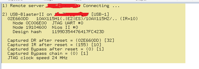

I have an intel FPGA devkit with Arria10. I am able to program the FPGA Sof through the quartus programmer GUI. But, when I try to use the command line option, then i get the Error (213013): Programming hardware cable not detected.
Here is the output of my jtagconfig --debug
my devkit is in index 2 and I tried the following command with no luck.
quartus_pgm -c 2 -m jtag -o "p;test.sof@1"
can you help?

removing the remote server connection at index 1 seemed to solve the issue for me. the following command still worked fine: quartus_pgm -c 1 -m jtag -o "p;test.sof@1"
