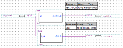

how can I input a hexadecimal value in the parameter table of a block diagram/schematic file (.bdf)?
behind the block is the following VHDL code:

the problem doesn't seem related to VHDL support in my view. You can neither send a hexadecimal literal to a numerical Verilog module parameter. Only decimal numbers seem to be accepted as block parameters for numerical values.
I'm using Quartus Prime Lite 22.1.2 and 23.1
With verilog it works for me like so:
Parameter | Value | Type
REG_BASE_ADDR | 4002 | Hexadecimal
But something like X"4000" or 16#4000# is not a VHDL-2008 thing, or is it?

This does not work. here is some test code:
library ieee;
use ieee.std_logic_1164.all;
use ieee.numeric_std.all;
entity test2 is
generic (
addr : natural := 16#4000#
port (
i_clk : in std_logic;
o : out std_logic_vector(15 downto 0)
end;
architecture arch of test2 is
signal reg : std_logic_vector(15 downto 0) := std_logic_vector(to_unsigned(addr, 16));
begin
o <= reg;
end;
generating a symbol from this code results in the following table:
addr | 16384 | Signed Integer
and synthesizes correctly to
using
addr | 4000 | Hexadecimal
results in an error:
Error (10515): VHDL type mismatch error at /asd.vhd(8): natural type does not match string literal
using
addr | 4000 | Auto
synthesizes incorrectly to:
May I know which block you're using in .bdf?
Sheng
The one you get by clickling File -> Create/Update -> Create Symbole Files from Current File in the*.vhd file.
the upper block with with Verilog works, VHDL does not.

Not exactly the same, but it will do, thanks.
