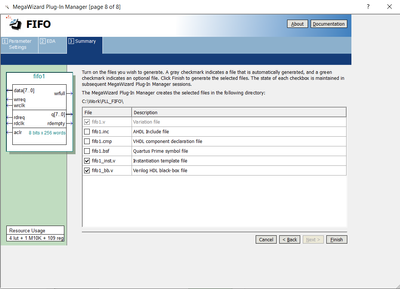

  3. Under [IP Catalog] on the right side, select Library -> Basic Functions -> On Chip Memory | Then double click FIFO | Give the FIFO a name, in my case I named it, “my_fifo” | click OK
  1. Under the common clock setting, select No -> Next
  1. Under DCFIFO 1, select Best metastability protection -> 3 sync stages -> Next
  1. Under DCFIFO 2, select Asynchronous clear -> Next
  1. For the next few prompts, leave as default until [Summary], where you select Instantiation Template File -> Finish
  2. As with the PLL, you will be prompted to add the files to the project where you will select Yes
