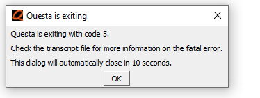

I have a bug similar to the one reported here :
https://community.intel.com/t5/Intel-Quartus-Prime-Software/Avalon-Verification-IP-example-avlmm-1x1-vhdl-not-working-in/m-p/1516388
I tried to follow the given solution, but it makes Questa sim crash. Moreover, it seems the -novopt option is deprecated.
If I remove the "-suppress 12110" option, Questa sim does not crash but reports this error, thus simulation is also not possible.
# ** Error (suppressible): (vsim-12110) All optimizations are disabled because the -novopt option is in effect. This will cause your simulation to run very slowly. If you are using this switch to preserve visibility for Debug or PLI features, please see the User's Manual section on Preserving Object Visibility with vopt. -novopt option is now deprecated and will be removed in future releases.

When vopt is enabled, I have the same issue as reported by someone else in this thread : https://community.intel.com/t5/Intel-Quartus-Prime-Software/Avalon-Verification-IP-example-avlmm-1x1-vhdl-not-working-in/m-p/1516388 .
When using avalon-mm BFM, the first transaction is ok but the second one gets stuck waiting for event_response_complete. The same code was working fine in modelsim.

Hello.
The problem is that the QuestaSim optimizer flashes the delta-events. If you are using multilanguage QuestaSim, the solution is to make little tunning in the "altera_avalon_mm_master_bfm_vhdl_wrapper.sv" file:
1) Change timescale resolution `timescale 1ps / 1ps
2) In line 519 add "#1", like:
always @(mm_master.signal_all_transactions_complete) begin
events[MM_MSTR_EVENT_ALL_TRANSACTIONS_COMPLETE] = 1;
#1 events[MM_MSTR_EVENT_ALL_TRANSACTIONS_COMPLETE] <= 0;
end
It will solve the problem. You can save the custom file and each Platform Design reconfiguration, just replace the "altera_avalon_mm_master_bfm_vhdl_wrapper.sv" file with a patched one.
