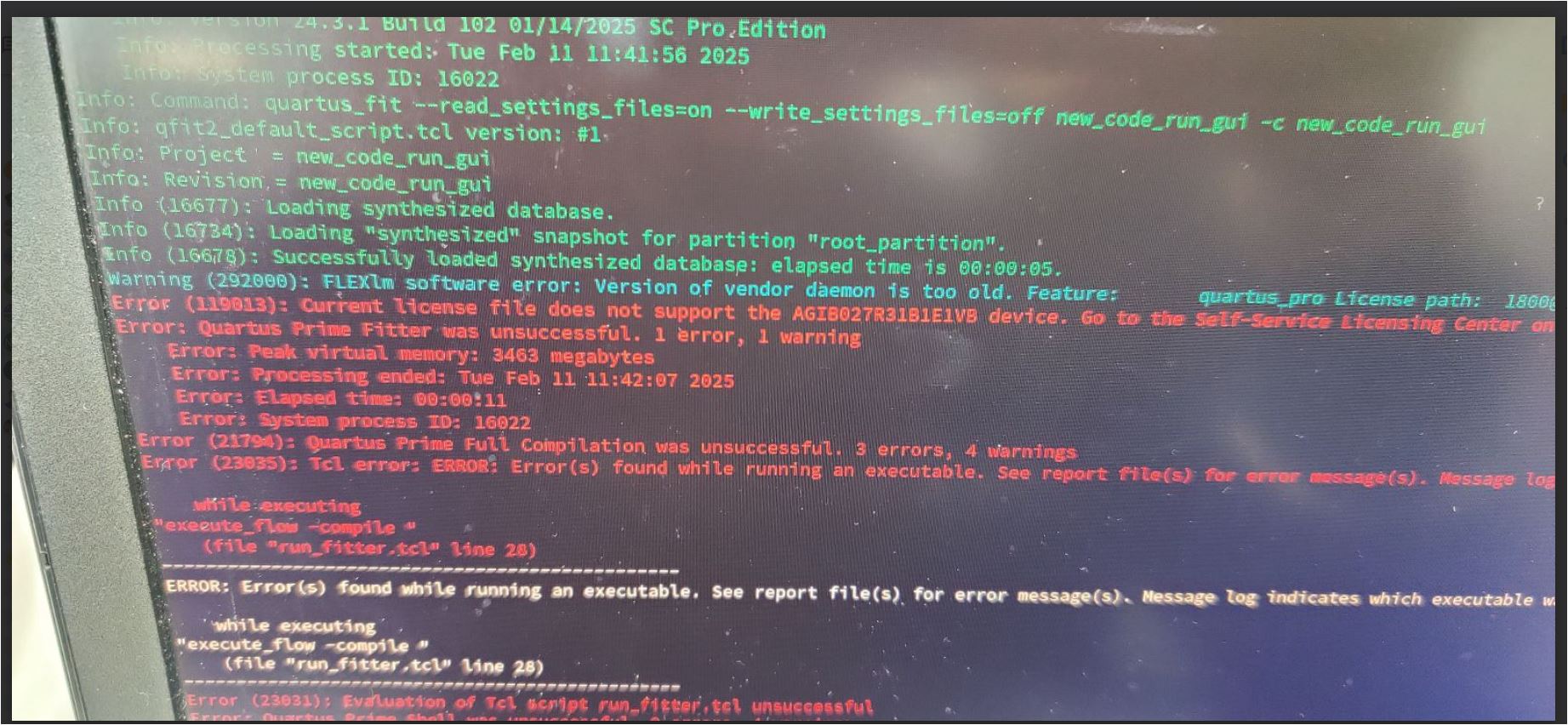

No license foe family Agilex 7 error is showing how to add Agilex 7 eval license
No license for family Agilex 7 error is showing how to add Agilex 7 eval license

Have you generate and setup the evaluation license with below Product License Summary?
# Product License Summary:
# 1 Intel® Quartus® Prime Software 90-Day Evaluation (Standard and Pro Editions) (License: EVALUATION-LIC), 1 Seat(s)

We have already used the same license file, but the issue is not resolved
Kindly give the solution on an urgent solution
I’m still unable to pinpoint what might be causing the issue, as everything is working fine on my side.
Would it be possible to set up a Teams call so you can share your screen and walk me through the issue?
I will send a separate email asking for your availability.

As per email conversation, please install the Quartus Pro software using the supported OS.
You may try to install on the non-supported OS but you will have to bear your own risk and there will be no technical support as well.
