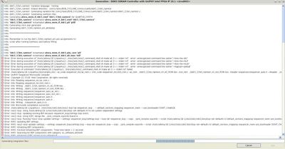

Hey to you all,
I'm using Cyclone V Soc development kit.
also I'm using linux operating system red hat 6.10/7.6.
when I'm trying to generate ddr3 example design I'm getting those errors:

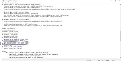

The requirement for operating system according to the readme.txt of quartus 18.1(attached to this call):
it seems to me like an operating system problem.

We are using quartus --64bit  version: 18.1 on Redhat 6 & 7 operating system,
please inform exactly what are the required libraries and packages we need to install/update.

we manage to find the problem.
our operation system used GCC compiler and quartus wants to use CC compiler.
we changed it and the problem solved.
