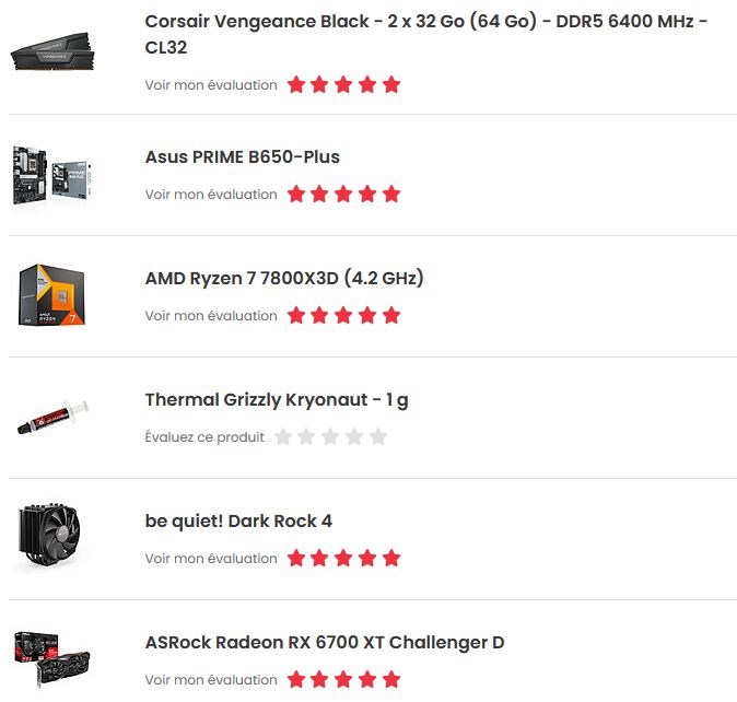

1. What is the brand and model of your desktop or motherboard?
-->    I have a home made desktop with an Asus PRIME B650-Plus motherboard, I put the specification of it in attchment.
