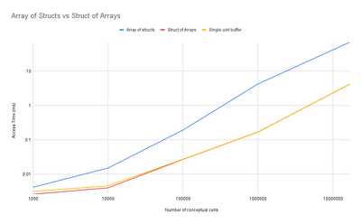

Classic optimization problem. Array of structs is simple, struct of arrays benifits from cache locality. I wanted to see the difference so i created the attached program. The program does a simple counting of occupied cells program with the intention that you need to gain read access to every cell. It produces the following result:

I then run this on different PC with very similar hardware:
Running array of struct vs struct of arrays on <Intel(R) UHD Graphics 620 [0x3ea0]> ...
Num cells | structure type | runtime average (ms) | runtime worstcase (ms)
1000 | Structs | 0.00415342 | 0.01975
1000 | Arrays | 0.0026213 | 0.003
1000 | S Array | 0.00317628 | 0.0045
10000 | Structs | 0.0151256 | 0.016333
10000 | Arrays | 0.00401343 | 0.004416
10000 | S Array | 0.00453666 | 0.006
100000 | Structs | 0.169097 | 0.642666
100000 | Arrays | 0.0272721 | 0.02825
100000 | S Array | 0.0276183 | 0.028333
1000000 | Structs | 4.2028 | 4.79683
1000000 | Arrays | 0.168516 | 0.427083
1000000 | S Array | 0.168989 | 0.334666
16777216 | Structs | 70.515 | 80.0608
16777216 | Arrays | 4.19573 | 5.04425
16777216 | S Array | 4.22549 | 5.05592
Here we can see that the array of structs is sometimes 40x slower than the struct of arrays! But the compute:

This is a expected behaviour as with SOA performance is better due to good access locality and cache line aligned transaction.
It is always more performant to access cacheline aligned data, data port can merge accesses and limit DataPort LSC to L3$ data traffic to transfer only few cachelines covering whole data block.
If you disabled cacheability of resources and next aligned performance to the bottom, then you can observe equal results. We suspect that for some reason of your machine exposes similar degradation.
Please set below environment variable to disable cache usage.
export ForceAllResourcesUncached=1
