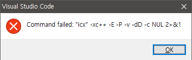

After update, Intel oneAPI: Configure cpp properties configuration command in vscode emit error if I choose icx option.
Error message is
Command failed: "icx" -xc++ -E -P -v -dD -c NUL 2>&1
as attached image.

Please provide a reproducer and exact commands used for your problem.
Is your original source code a .c or .cpp file? For .c file you need icx to compile, but .cpp file requires icpx to compile.
Check the "guiding principle for icx" section in this document: https://www.intel.com/content/www/us/en/developer/articles/guide/porting-guide-for-icc-users-to-dpcpp-or-icx.html
If above doesn't answer your question, please attach a reproducer to demonstrate your issue and list the exact commands used.
There is inconsistent information.
A document from intel, it says icx (icx-cl) work as c/c++ compiler driver in windows and "icx is the recommended default driver for Windows." in Intel® oneAPI DPC++/C++ Compiler Developer Guide and Reference, page 12-13.
then which is correct?
Since you're using the Windows OS, icx is indeed recommended as it is the MSVC compatible driver. Using icx is equivalent to using icx-cl on Windows OS. The use of icpx or icx-cc are there for Windows, but icpx and icx-cc are Linux compatible drivers, which mean they accept the Linux style options, but the behavior targets Windows based targets. When you use icx, you also use the MSVC compatible driver so this driver does not accept -dD or -xc++ or any other Linux specific options. Using icpx means using the Linux based driver, which allows for those options to work.
In my case, my c++ source should be linked with other c++ object files which is from MSVC compiler, so icx will be easy way. (I already tried with icpx, but occured some linking error.)
I noticed that MSVC compiler don't support "-dD or -xc++" flags.
We solved the inconsistent notions, and it is the time to deal with vscode oneapi extension bug..
1. "Intel oneAPI: Configure cpp properties configuration" command bug. (This command is from "Analysis Configurator for Intel® oneAPI Toolkits" in vscode extension)
This error didn't appear in oneapi 2023.2 and ran well.
I tried downgrade "Analysis Configurator for Intel® oneAPI Toolkits" to several versions, but not work (lower version cannot generate settings.json)
User cannot change the command "Intel oneAPI: Configure cpp properties configuration", but wait newer version of "Analysis Configurator for Intel® oneAPI Toolkits" extension supporting oneapi 2024.1 for windows vscode.
(no way to remove -dD or -xc++ flags in vscode command)

Hello.
I found this problem is solved at software of versions as following.
oneAPI : 2025.0
Analysis Configurator for Intel Software Developer Tools: v0.1.27 (vscode extension of oneAPI)
Thank you for patch!
