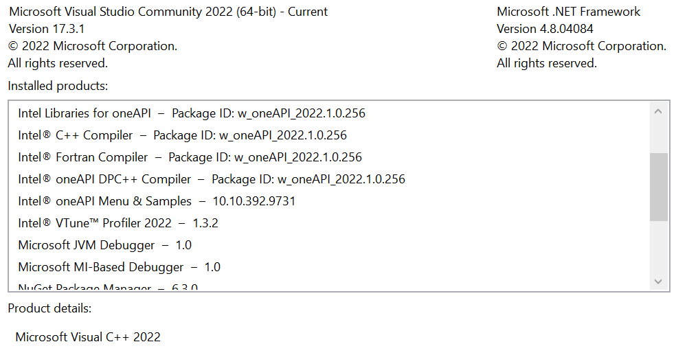

Just installed VS2022 & Fortran 2022.2.
When trying to open an old project, this error message pops up.
Follow the message, opened ActivityLog.xml and found some error entries, like these:

What's this ICXOneAPIPackage package ?

Steve_Lionel
11,074 Views
I think that's part of Intel C++.

Created a new project. But when trying to reopen it, a new error message pops up (attached).
After disable it as suggest, it could be reopened.

Steve_Lionel
11,026 Views
I haven't seen that "oneAPI menu" issue before. The file opening issue is allegedly fixed in the next Fortran update - I find it annoying, but not a deal-breaker.
