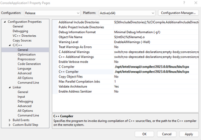

are there any plans to support WSL2 in the near future - or is there already a workaround how to add the Intel compilers to the Platform Toolsets in a WSL2 Project?
Daniel
SeshaP_Intel
4,954 Views
Currently, IDE does not support choosing the platform toolset in C++ Linux project in Visual Studio.
But we recommend the following method to use ICX and DPC++ in Linux projects.
1. After connecting to the target Linux system in Visual Studio, choose the platform toolset "Clang for Windows Subsystem for Linux"
2. You can specify the path of icpx, for e.g.
C++->General->C Compiler: /opt/intel/oneapi/compiler/2023.0.0/linux/bin/icpx
C++->General->C++ Compiler: /opt/intel/oneapi/compiler/2023.0.0/linux/bin/icpx
Linker->General->Linker: /opt/intel/oneapi/compiler/2023.0.0/linux/bin/icpx
3. Then the project can be built with ICX.
Hope this resolves your issue.

thanks for the information. What I'm looking for is the Intel compiler in a VS linux project. So I like to select the Intel compiler here:
This is a screenshot of a Windows Project. The VS-Linux project lists just GCC and Clang as Linux compiler toolset - Intel is missing.

thanks for your solution. I think I can work with it. Do you plan to have a native support for your compiler? Specially to give access to the custom options of it that are not accessable through the clang template?
