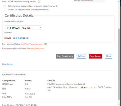

Provisioning Record State: Pending Activation
SKubo
9,719 Views
I installed the EMA agent on vProPC, but IntelAMT provisioning is failing.
Currently, the EMA server hostname and the management console URL (FQDN) are set to different values, but in the IntelAMT automatic provisioning settings, the FQDN setting is specified as "Shared with host os". Do I need to change this setting to one of the following?
Are there any other possible reasons why provisioning may fail?
Skubo

Also, as additional information, "Warning: Host Based Admin Setup failed-AUTH_FAILED:
(<Comptername>)" three times, and finally a "Failed PKI provisioning" message.

After creating a profile for HBP settings and installing the agent on the vPro terminal, the settings were completed in CCM without any issues.
All remote control functions are available except for "Hardware Manageability."

The issue for "Hardware Manageability is due to CIRA connectivity.
Please refer to the link below, follow the steps provided, and update us on your progress.
Link: https://www.intel.com/content/www/us/en/support/articles/000092506/software/manageability-products.html

State: Not Provisioned
Control Mode: None
I suggest restarting the endpoint after installing the EMA agent file.
In addition, as a test, please access the EMA web console, and look for the endpoint called LAPTOP-PQ1CORSE. Give 5 to 10 minutes, and check if Provision status changes. (Please share a screenshot of it and a new ECT log)
An alternative troubleshooting, click the actions button and select Provision AMT devices. In the next window, try Deleting the provisioned machine. I want to confirm if the endpoint was provisioned by the current EMA instance or by a previous instance.
Please include if the laptop is using a wired, wireless, or docking connection plus location; is it remote or in the same Server domain.
