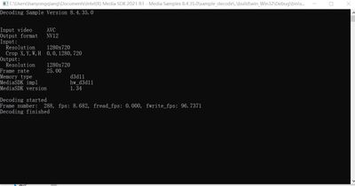

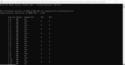

yoe
3,516 Views
1)Media SDK version: 1.34
2)API version: 1.20
3)Because the code of the mediasdk header file used in our program has been modified by us, direct replacement is not feasible and it is very difficult to combine.
----PS:I tracked it with SDK tracker and found that it was caused by the failure to load libmfxhw32.dll. Why can sample load successfully, but my program can't load successfully?
